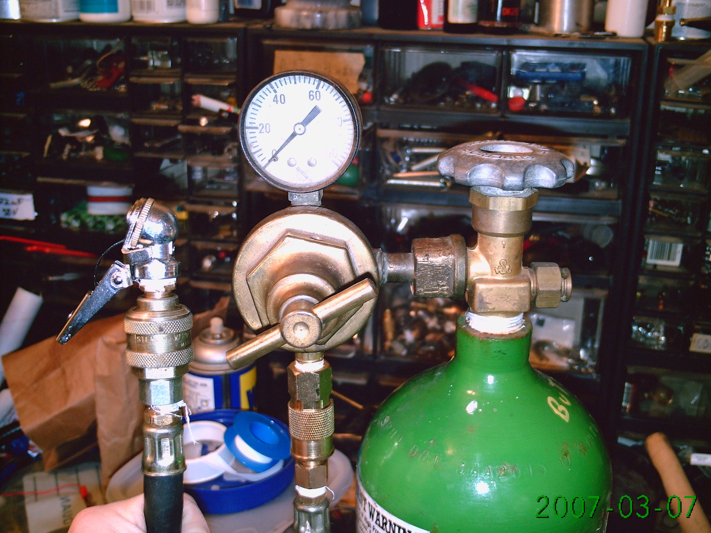

Step 2: The Compressor
An air compressor has three main parts, a pump, a motor, and a tank. To get these you can go to you local scrap yard, they usually have a few scrapped compressors that can give you a pump and sometime a usable tank, if not with a bit of work you can use a AC compressor from a car, if either of these is unavailable harbor freight tools sells compressor pumps. For a motor you can get one from you local motor repair shop or from a scrapped washing machine, electric lawnmotor, or even a gasoline engine(this one would require a pneumatic clutch). And as for a tank you can use one from a old compressor, but I like propane tanks, you can get from walmart or ameri-gas(amerigas usually have old tanks that have the valves removed I bought my tank for $3)
