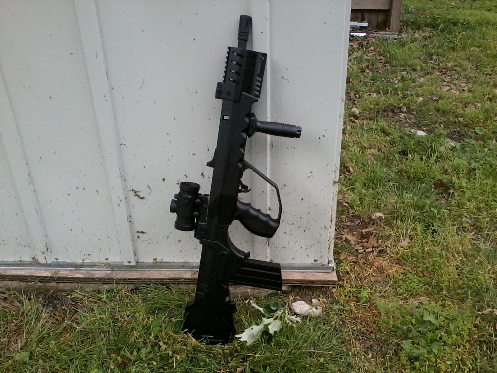

Put a cardboard circle in on top of the spring and use your compression tool to press it down. Insert the retaining pin and pull the compression tool out. It should look a bit like the first pic. Then, pour in as many pellets as you think it can fire. Then, push the second cardboard disc in with the compression tool. Now, when you want to fire, just pull the pin out. It took me four tries to hit a target at 10 feet, but after mounting it on a weapon, this is the spread I got with it. I figure range to be 25 feet at best.
