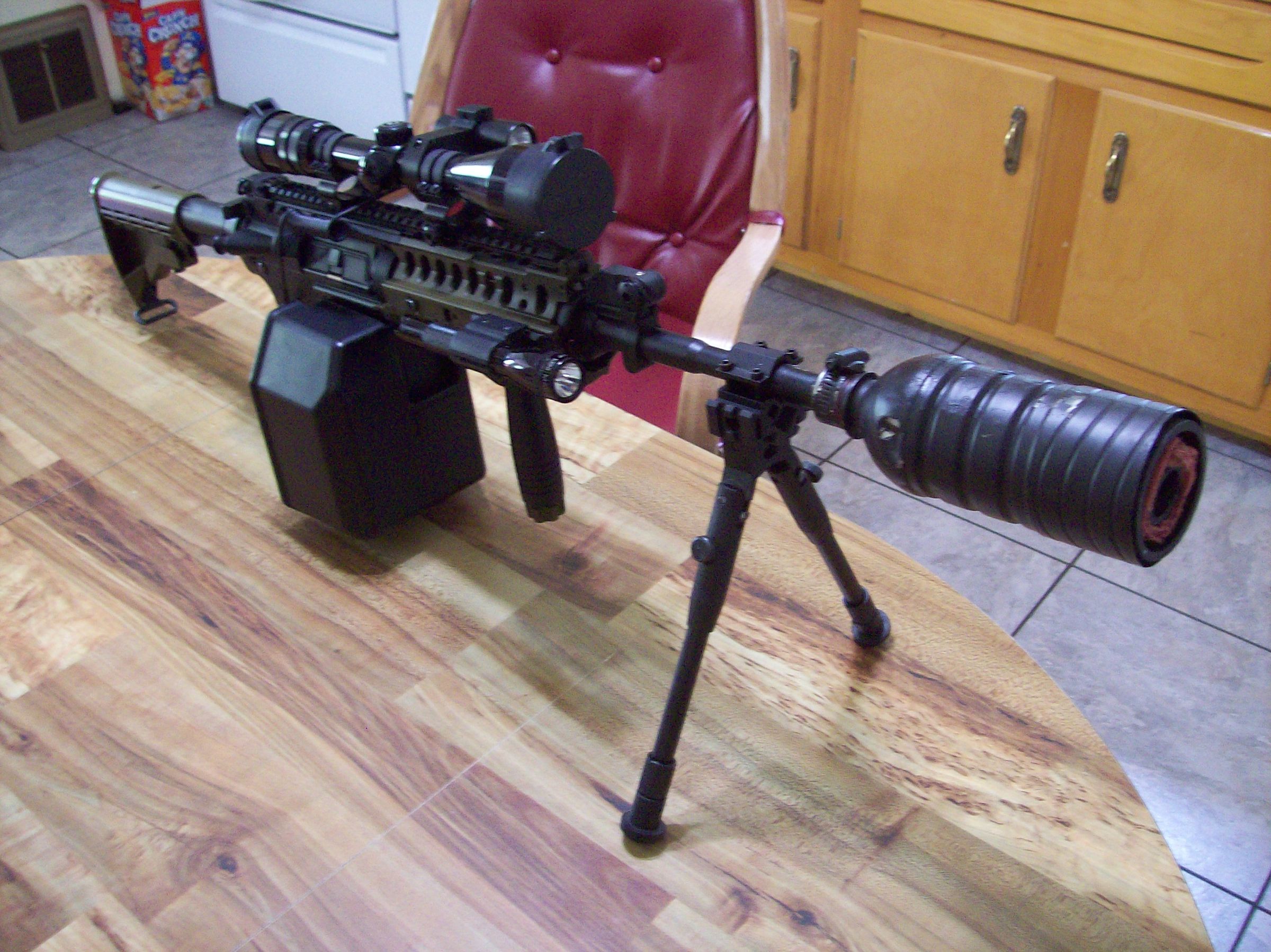

ok, i got sick of seeing all these arisoft silencers online for like $50, and they really dont make your gun much quieter, so i decided to make a $4 silencer that works just as well as the $50 ones. Granted it doesn't look as good as the ones online, but for my uses it works fine. This is my first instructable, so sorry if i don't get it exactly right.

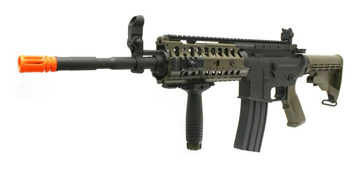

Step 8: Cut Neck
The flash hider on my gun was too big for the bottle to fit over, so I cut the bottle so that it would fit. It was still tight, but it worked.
Step 9: Add Hose Clamp and Install
Put the hose clamp on the spirals on the neck, then slide onto the flash hider of your gun and tighten the clamp. How you paint it is up to you. I hope my instructible was useful to anyone interested.
