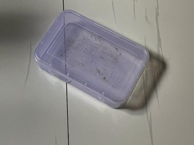

Step 1: Before Making Transmitter We Have to Make Body for Transmitter
we can use transparent box
or
3D printed body for transmitter - https://www.tinkercad.com/things/jRgCi3VNCl7-rc-d... , https://www.tinkercad.com/things/jRgCi3VNCl7-rc-d...

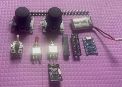

Step 2: Matarial :
Joystick Controller - https://www.amazon.in/Robocraze-Joystick-Module-P...
ATMega328P IC (28 Pins) with 28 pin Base (Controller IC) - https://www.amazon.in/ATMega328P-Pins-pin-Base-Co...
Potentiometer - https://www.amazon.in/AVS-COMPONENTS-Potentiomete...
toggle switch - https://www.amazon.in/Electronic-spices-Electrica...
16.00 MHz Crystal Oscillator with 22pf Capacitor - https://www.amazon.in/16-00-Crystal-Oscillator-22...
5 Volt 1.5 Amp Positive Voltage Regulator - https://www.amazon.in/KTC-CONS-Labs-Positive-Regu...
3.3 Volt Positive Voltage Regulator - https://www.amazon.in/AMS1117-3-3-AMS1117-3-3V-Re...
NRF24L01 with antenna - https://www.amazon.in/NRF24L01-wireless-transceiv...
NRF24L01 without antenna - https://www.amazon.in/KitsGuru-NRF24L01-Wireless-...
10uF capacitors - https://www.amazon.in/ERH-India-20-Pcs-Electrolyt...
General Purpose Printed Circuit Board, 5 Pieces + Female Berg Strip, 5 Pieces + Male Berg Strip - https://www.amazon.in/Generic-B00C743253-Componen...

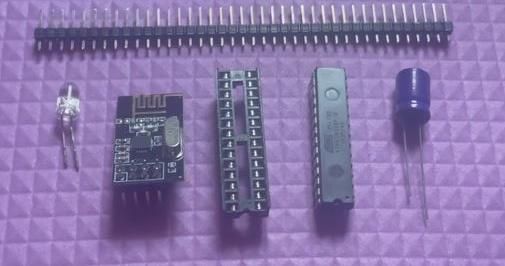

Step 3: Matarial :

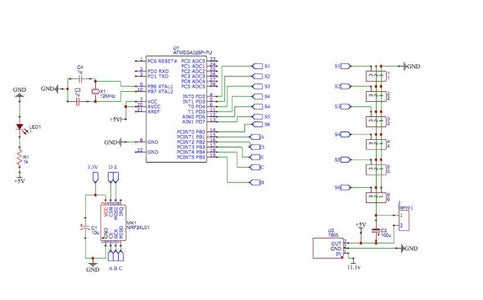

Step 4: Circute Digram Transmeter
Step 5: Circute Digram Receiver
