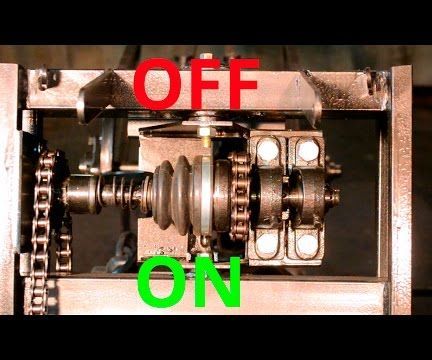

Set the middle shaft. It distributes the torque from the engine to the all-wheel drive. The shaft diameter of 25mm. It established stars. Transposition chain from one pair to another pair of stars, Commission, and reduced or increased transfer.

Video from my Russian YouTube channel. There are subtitles. In this video, I collect rotation unit. I use constant velocity joints of the Oka car. On it I install the star 15 teeth for chain steps 15,875mm
Step 11:
