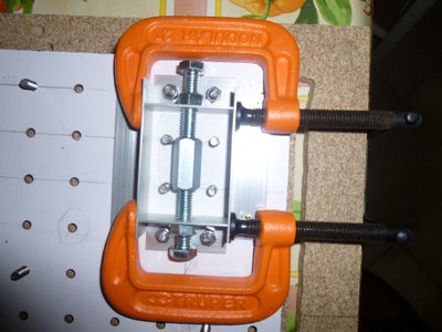

I built a mold with aluminum profiles.
This box will hold the nut as shown in the images.

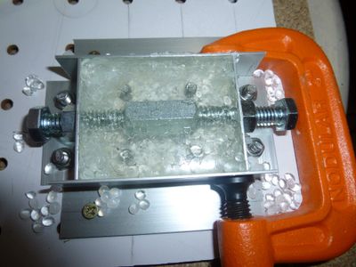

Step 1: Filling the Mold With Thermo Plastic Balls
I then placed the plastic balls inside the box and melted them with a hot gun. I set temperature at 70 celcius degrees and heated the plastic until it melts and becomes transparent.
Step 2: Cool Down... the Final Step
Once it get cold, dissasemble the mold and the nut holder is ready to install.
