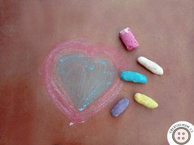

One-word answer – well. I saw store-bought chalks of different quality, from excellent ones to chalks with colors so pale that you couldn’t distinguish between pink and blue. (Our) Homemade Chalk can compete with the commercial chalk. It’s rather hard and not always perfect for drawing all details but we are very happy with it. And you can shape it for your or your kid’s hand!
For this tutorial I made 5 chalks from brown egg shells, four of them dyed with gel food colorants and one without any dye. As you can see, the chalks draw well and even the white one is ok.

  8. Or you can roll it in a paper towel, the result will be more smooth. Let the chalk dry in a dry place for 2-3 days. It has to be absolutely solid. Before you use it, press it lightly with your fingers. If it’s even a little bit soft, let it rest for one more day.
