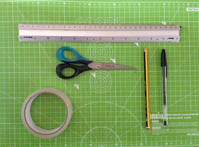

Tools:
- Scissors(or scalpel if you have one and would prefer)
- Printer
- Computer
- Ruler

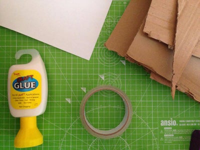

Materials:
- Paper – doesn’t need to be new, could recycle an old bill, whatever fits in a printer
- Cardboard – again doesn’t need to be new, my supply of cardboard comes entirely from waste packaging
- Pva glue (optional)
- Sticky tape

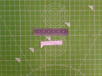

Step 3: Print Out and Calibrate Ruler
The first step in this build is to print out the primary and secondary scales used to create the ruler. Either grab an image off the internet or download the pdf provided:
http://www.mediafire.com/file/ije05ggxdiqrmeq/parts_diagram.pdf
You may need to calibrate the ruler, by this I mean line up the print out with an actual ruler to check that it is the right size. This could be a problem when using different A good forward thinker like myself will print out 3 or 4 slightly different sizes to cut down on wasted time, and 4 are provided in the pdf.
When you have found the calibrated set of scales, cut them out using scissors

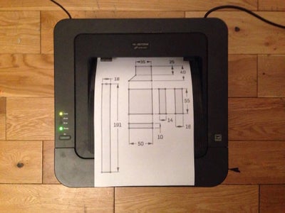

Step 4: Print & Cut the Body Parts
A cutting pattern has been provided in the pdf below for the shape of the caliper:
http://www.mediafire.com/file/w808klf92zmzz88/vernier_caliper_project.pdf

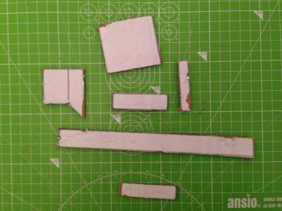

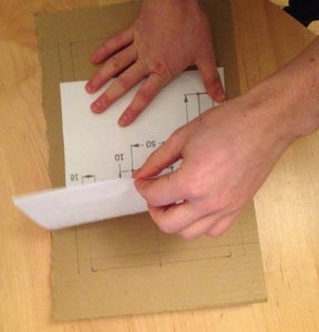

- Cut out the shape
- attach the paper to cardboard using sellotape or a small amount of PVA glue.
- cut out the pieces
Step 5: Assembling the Parts
make sure the scales will fit onto the body before assembling the caliper, in the way shown in the GIF
In general, part A is needed to slide the primary scale across. Part B is the ‘arm’ for the primary scale. Part C&D fit above and below part A, and the secondary scale should fit on Part C. Part E and F keep parts C & D close to part A.
