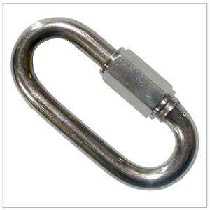

1: Take the amount of chains you will want to use and attach them evenly around the bike tire with some sort of connector, whether it be you drilling your own holes in the metal or using a chain connector. Once you have all of the chains attached in your desired locations, bring the bike tire to the very top of the wooden pole. Drill the tire onto the top of the pole to where the chains hang down freely.
