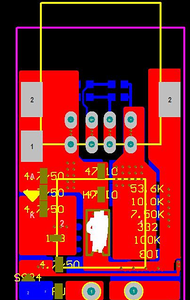

Step 1: PCB Board Diagram
Let's check the PCB board diagram firstly.

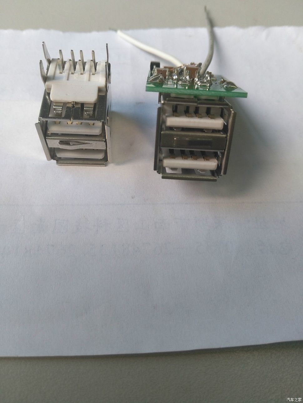

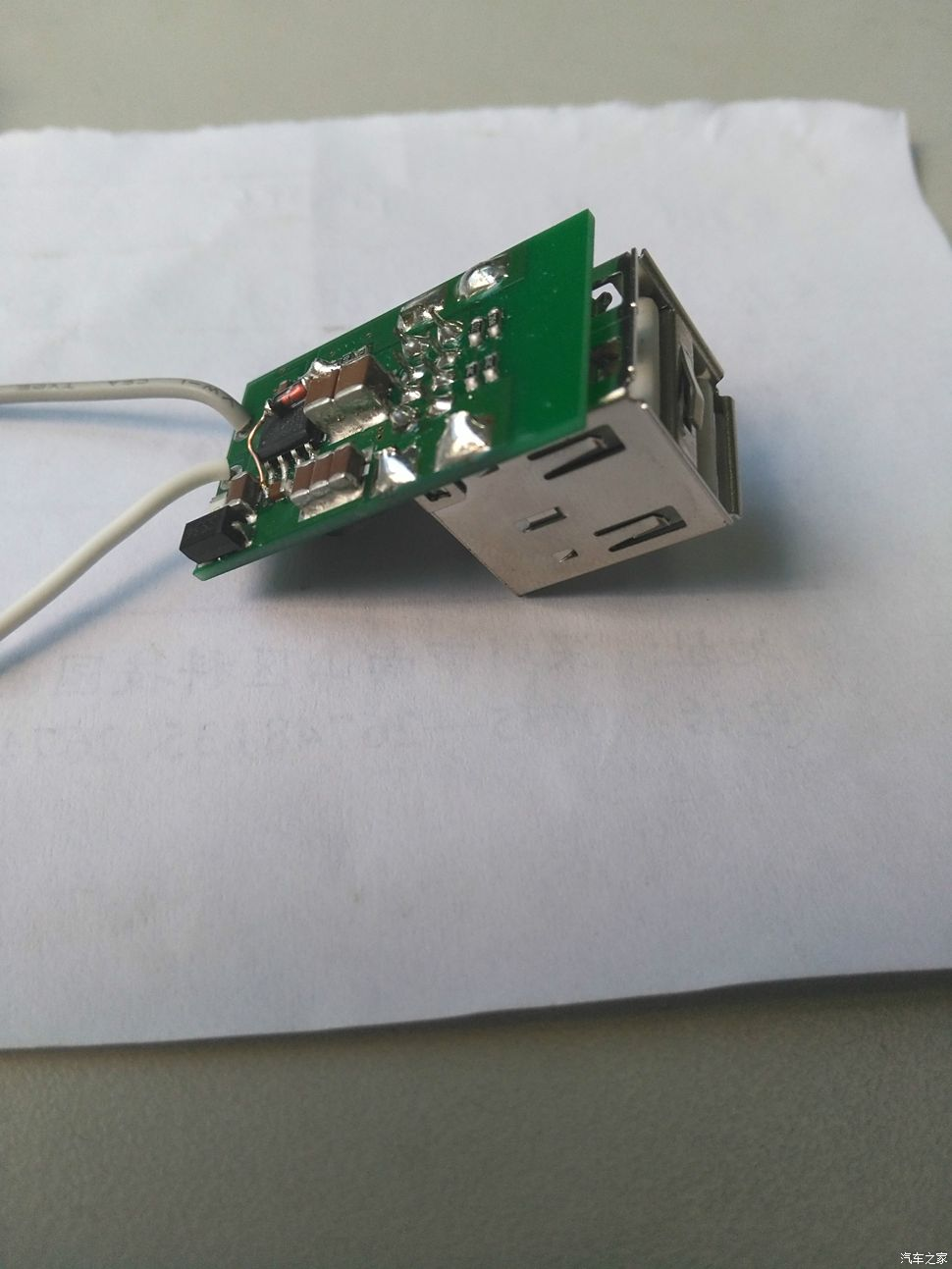

Step 2: Soldered a Diode
A diode was soldered onto the IC. During debugging, it was found that when the input voltage was adjusted upward from 0V, the output voltage was always only 3.7V, which was an undervoltage protection. A diode was added to solve the problem. The red circle is the Apple phone monitoring resistor.

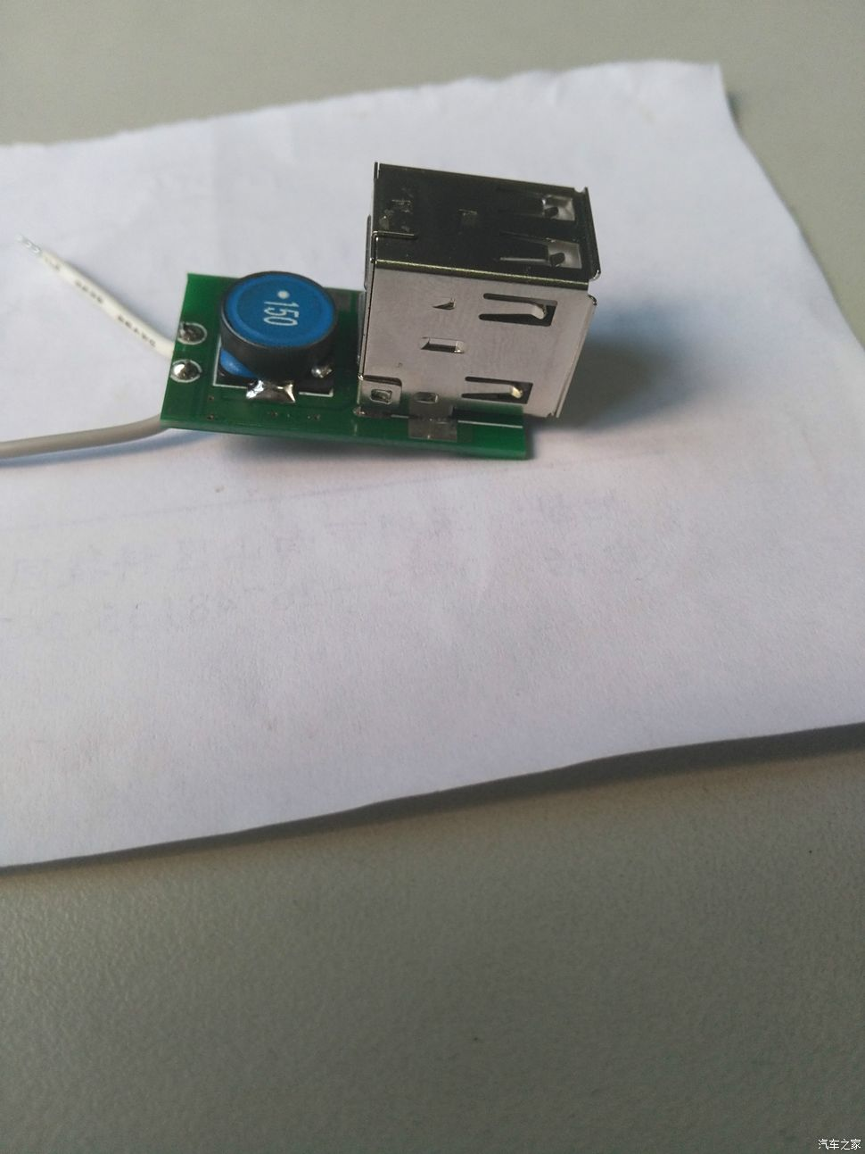

Step 3: More Details

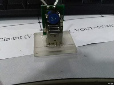

Step 4: Secure With Glue

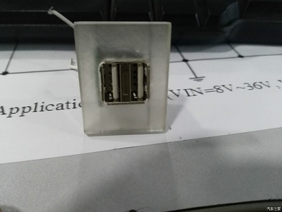

Use acrylic to make a cover plate 36*28*5mm fixed plate. The thickness of the acrylic needs to be 10mm to be flush with the cover plate on the car without any steps.

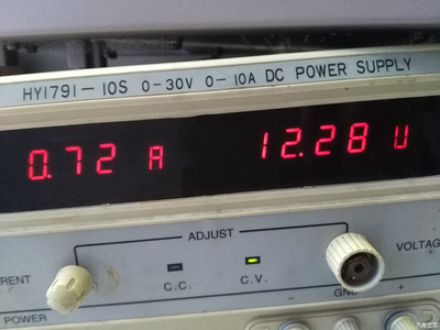

Input parameters 2 mobile phones are charged. 1 Huawei 5X starts at 62% battery, 1 Apple 4S starts at 22% battery.
The total input current of the two mobile phones is 0.72A. The input voltage is 12.28V = about 8.8W. If the battery of the mobile phone is very low, the input current will increase.
The conversion efficiency of this machine is about 95%, and the heat is not large.

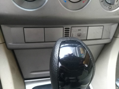

Step 7: Installation
After it is done, prepare to install it in the hole on the left. There are 4 holes. The second one on the right is occupied. The other three can be installed at will. Prepare to install it in the first hole on the left.
