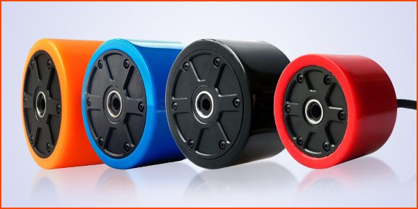

Step 2: Take Measurements of Your Hub Motor (for Modifying Existing Trucks)
There are custom built trucks out there for these hub motor setups, but I wanted to minimize the cost of this project, so I decided to modify my existing trucks to fit the hub motors as they mount slightly differently than a standard longboard wheel.
As you can see in the first photo, the hub motors have a motor built into the wheel, and my hub motors had a square hole for the trucks to fit into to keep it in place, and these motors are almost flat on both sides whereas a regular longboard wheels are usually tapered in the center.
In order to fit these hub motors into my trucks, I had to remove a precise amount of material off my trucks to reveal the shaft. You can see the illustration in the second picture. Note that I also have to remove material on the regular wheel side of the trucks in order to make both sides equal in length when the motor and the wheels are in place. This will all make more sense in the next few steps.
