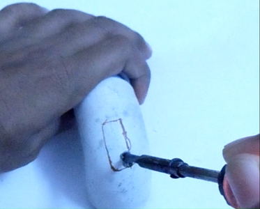

Step 3: Construction - Drilling Holes
Measure the dimensions of the switch and mark them on the PVC Pipe. Once marked carve a hole using a cutting tool or with a help of soldering rod.

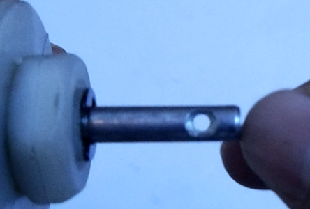

Cut the pen using a knife or a cutting tool so it can fit both the motor shaft & screw driver. After cutting take a piece of waste plastic sheet and cover the motor shaft & then insert the chopped pen as shown in the image 1 & 2.
Now mix some metal paste and insert it to one side of the chopped pen as shown in the image 3.
Now insert the screw driver and add some more metal paste to secure it as shown in the image 4 & 5
Note : Leave the metal paste to dry for some time

Step 9: Construction - Screw Driver - Part 2
Once the metal paste is dried make a hole in the pen matching the hole in the motor shaft and then secure it with a screw.
