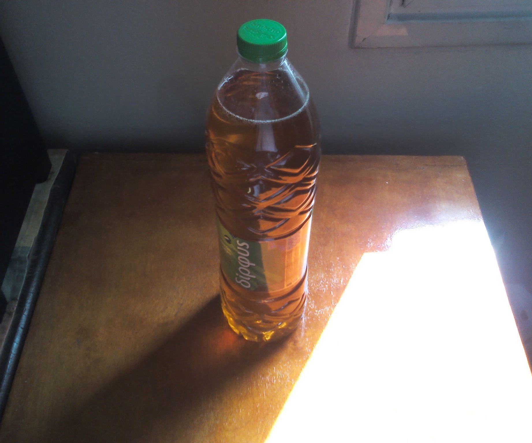

Step 10: Soaking Container
Take a food container and put some used cooking oil. Place on top of the container a piece of wire mesh.
