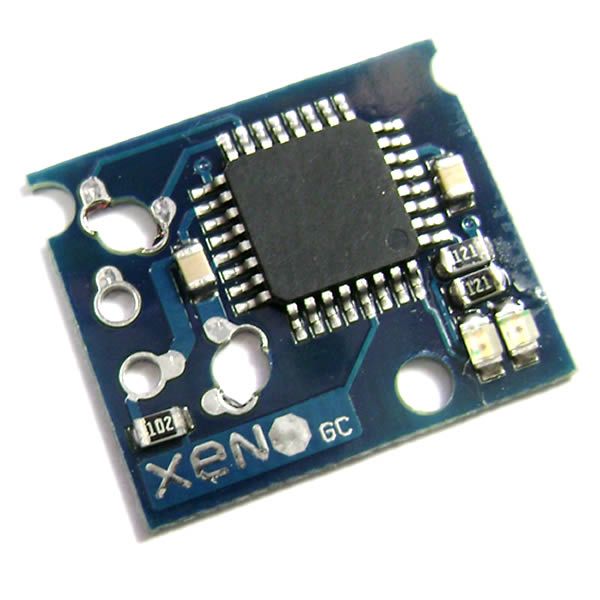

There are optional LEDs used on this
mod-chip to indicate whether the chip is communicating with the disc drive's service serial port correctly. Green means it is operating correctly; red means there is an error. They can be removed from the circuit, along with the resistors in series with them when the chip is installed into the GameCube, or they can be left in and located discretely on the back of the GameCube.
Shown in the images are schematics of the mod-chip with the required parts included. There are two versions: one with an ISP header (the connectors used for flashing the firmware onto the mod-chip) and one without (the “economy” version). The ISP header version will be built on a breadboard for flashing then replaced with the economy version before being installed into the GameCube.

Step 4: Building the Chip
There are a multiple methods that may be implemented to construct the mod-chip; a PCB can be made and the components soldered to it, components can be soldered to a perf-board, or components can be connected via the point-to-point soldering method. The point-to-point soldering method is explained in this instructable.
The green and red LEDs and corresponding resistors are optional. They are used to show that the chip is operational. When the disc drive begins to read a disc, the red LED will be illuminated. If the chip communicates with the drive correctly, the red LED will go out and the green one will light up. If the LEDs are to be installed, a place to mount them on the GameCube is required. Taping the LEDs in the rear vent as shown in the video at the intro and final steps is suggested.
For this GameCube, the status LEDs and corresponding resistors are not used.
To solder the components using the point-to-point method, first wrap the leads of the 1KΩ resistor around pin one and the VCC pin of the Atmega8. Solder the leads, then cut off the excess leads of the resistor. Next, use a piece of wire or the trimmings of the resistor leads to solder a jumper between the AGND and GND pins using the same method used on the resistor. Then wrap, solder, and trim the excess leads of the 0.1μF capacitor to the GND and VCC pins of the Atmega8 as shown in the image. Lastly, strip and solder 4 to 5 inch long 30 AWG wire to pins 15, 17, 18, and 19 as well as the VCC and GND pins of the Atmega8 as shown in the image. Strip the other ends of the wires back about 1/8 of an inch.
