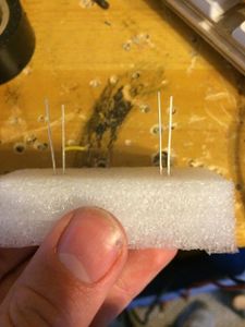

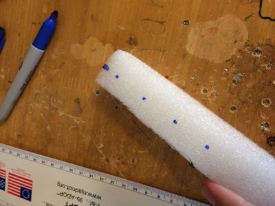

Step 1: Preping the Foam
To start things off, let's get the foam ready. The foam not only acts as a mount for the LEDs, but it also acts as a diffuser (is that a word?) for the light.
First cut the foam in a 1in. by 10in. pattern. Next, mark a 1/2in. in from one of the ends, then mark the foam for holes 1 - 1 1/2in. apart down the middle.
After that, take your Poking Implement 3000 (In my case I had a 3mm steel shaft that worked fine) and poke a hole all the way through where you just marked.
The last thing we are going to do with the foam is going to be using the scissors to cut a long slit in-between the LEDs and the bottom of the foam to slide the gnd wire in.
With the foam ready, we can get to the LEDs now.

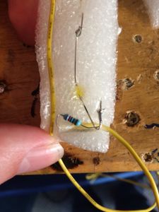

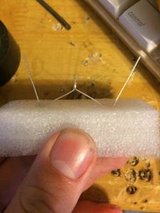

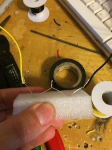

Step 2: Mounting and Wireing the LEDs
Now, we will mount the LEDs. Take the first 2 LEDs in your strand and stick them into the mounting holes in the foam. Make sure that both positive leads on the LEDs are facing the same way.
Next, solder the positive and negative leads that are pointed toward the middle of the two LEDs together. Then solder wires to the two remaining leads. Repeat this 4 times.
After that, take all the wires that are soldered to the gnd leads, and solder them to the gnd wire that is going to be directly connected to the power.

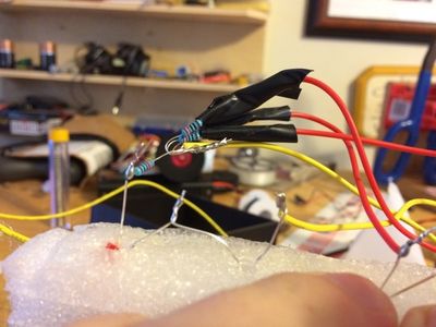

Step 3: Resistors
Now, since we have 4 sets of LEDs, we need 4 resistors.
Cut a long wire that will be connected to the + of the power source and solder the 4 resistors to one end (making sure that they are oriented the right way). And cover the joints with heat shrink or electrical tape.
After that, take the opposite ends of the resistors and solder the + wires of the LEDs to them.
To rap up, take the bundle of wire/resistors, and hot glue it to the foam.

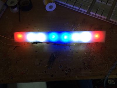

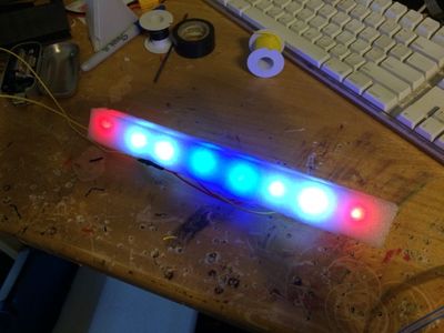

Step 4: You're Done!
Congratulations! you just saved $10! :P You can use this to light your work-bench, as a decoration, or anything else you can think of!
