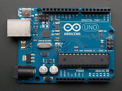

Step 3: Wiring and Programming
The wiring is pretty simple:
You connect the three servo motors to GND and to the current (5 volts), then you connect each motor to their pin:
- 9 for the motor that controls the horizontal movement of the eyes.
- 10 for the motor that controls the movement of the jaw.
- 11 for the motor that controls the vertical movement of the eyes.
Then copy and paste the Arduino code into a new sketch and run it with Arduino.
