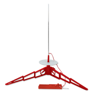

Firstly, the rocket is to be mounted on a standarized Estes rocket launch pad (supplies) or any suitable launch pad with a launch rod. Once mounted, the igniter should be clipped to the remote. Make sure the clips do not touch each other. Once full connected, you may step back and initiate the launch.

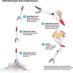

During flight, the rocket will have a certain amount of thrust and burn for a certain amuont of time. The engine used in this model is the D12-3 engine (supplies). The name D12-3 is based upon its statistics. "D" is the typing of the engine in which it produces 2x as much thrust as a "C" engine. D engines produce roughly 7.4 lbs of thrust. The "12" is the amount of propellant inside. This should not matter as all D engines have the same amount of propellant therefore they will burn for the same amount of time. Finally, the "-3" is the delay until the ejection charge.
The ejection charge is what starts the next phase of launch. Given the engine for this rocket, the D12-3, the "-3" is the amount of time in seconds until the ejection charge burns. The ejection charge is basically one final burst of propellant that shoots out the other side of the engine which will stage the rocket and deploy the parachute. So, the "-3" means that after the main propellant burns out, the engine will burn for rougly 3 seconds before the ejection charge ignites and stages the rocket.
Finally, the parachute should be deployed and safely bring the rocket to the ground. If the parachute cords do get tangled then what is able to expand should slow the rocket down enough for very minimum damage that can be ignored for the next launch.
