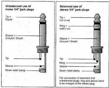

The piezo disk comes with a red and a black wire attach to it by default.
If it's not the case because you scavenge it (good job!), the center part of the disk is the ''signal'' and the external part will be soldered to the shield or negative of your cable.
Solder one end of the cable carefully on the disk since it is pretty sensitive to heat.
Solder the other end of the cable to the jack. Checkout the diagram if you're not sure.
The process is fairly easy, the piezo can be connected directly into a power amp or a pre-amp or even a recorder/sound card.
