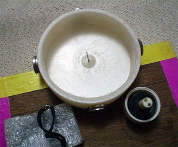

  1. Plastic rotor (you can use a lid of cold cream of this matching size)
  2. Glue or a strong adhesive for sticking magnets equally to four sides of rotor

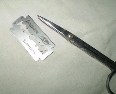

  9. Shaving blade
  10. Small scissor

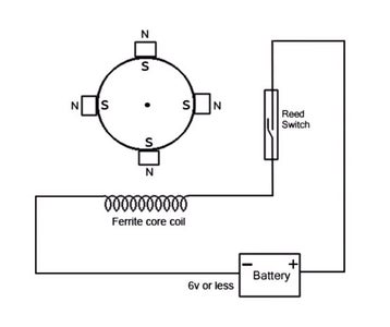

Step 2: Procedure

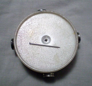

  1. When you get all the materials, take the plastic rotor, insert the pin into its center.
  2. Take rotor stand with pin hole similar as you see in picture and stick it to board with supporting material fixed to the board.
  3. Stick four neodymium magnets equally to four sides of rotor and also vertically equal in between on all four sides.
  4. Make sure all magnets are facing either north or south.
  5. You can now mount rotor on the stand using pin and check if it rotates smoothly

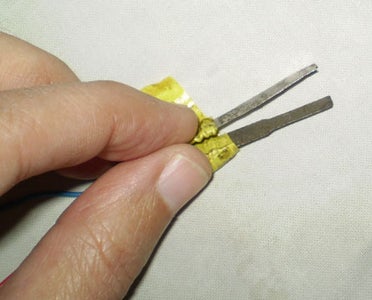

How to make Reed Switch
  1. You can see thin metal strips more clearly in images with length of blade.For more better result i took one strip a little thicker from a battery joint of junk electric racket.
  2. Cut two thin strips from a shaving razor blade and attach them to jumper wires either through soldering or wind with thin copper wire after removing its insulation with candle flame or sand paper.
  3. Insulate the two strip ends with electric tape and wind together with electric tape

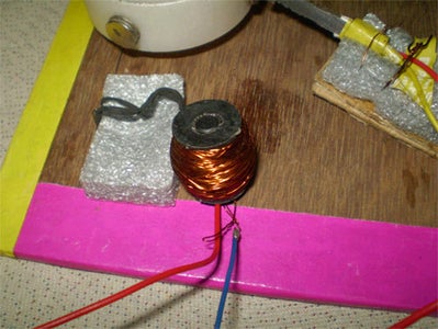

Ferrite Core Coil

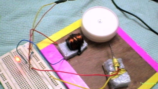

Ferrite core coil has more than 450 copper winding with a cylindrical ferrite core inside. If you do not get ferrite, air core coil also works. Advantage in ferrite core is that it produces more energy with same current. Attach the core to the board as shown in the video or may use any other way you like. Bring reed switch, rotor, ferrite core together in alignment and make connections as you can see in diagram or video.
You can make wire connections directly as shown in diagram or using breadboard whatever you like. Reed switch requires some directional adjustment for better performance. Follow the video carefully and give power supply from 5 to 6 volts When you find rotor with good speed, you can test energy output to neon bulb by connection as you can see in video. Make sure that magnets, reed switch, coil are aligned properly in parallel.
