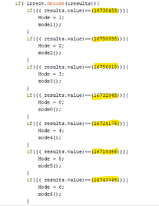

I've attached all the files you need. Move them into a folder and run "project_IRLed3_6.ino".
As you see in the image, the highlighted numbers are the codes for the remote control. You should change them according to your remote.

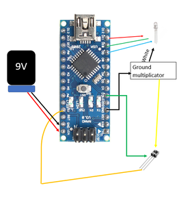

Here comes the fun part! Connect everything as seen in the picture. If you have any questions, feel free to write them in the comments! Then you'll need to fit everything in the empty bulb. Now click on the top of the bulb.
NOTE: When assembling the bulb, make sure that the IR Receiver sticks out through the hole you made previously.
UPDATE (4/25/2020): I just figured out the fact that the red wire of the RGB should go to pin 5. Otherwise, the red color won't work!
