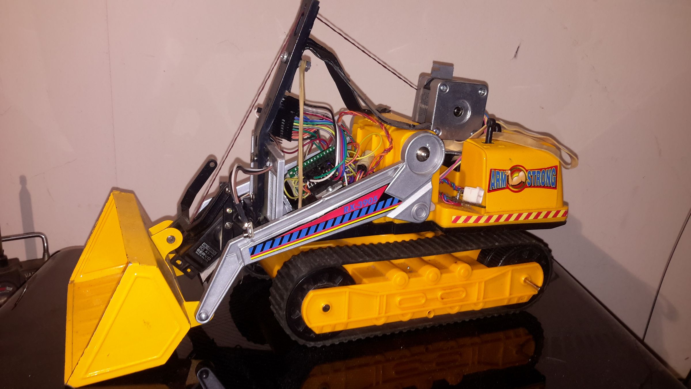

I found a photo on the internet and start building this Robot arm, i started from one end and work forward, so i not have plans of this build.
I look in my scrap and found a pice of aluminium about 0.8 mm, it is soft and lightweight and strong enough for this build
Base is from an old printer and a stepper motor because i not have a servo motor that is strong enough and want keep cost low, if possible use a servo because it is faster,
Cut and file aluminum and screw it toghter.
