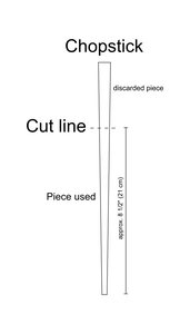

Step 1: Cut the Chopsticks
I cut my chopsticks about 8 1/2" long (22cm). I did this on the band saw, because it was quick and easy, but you could cut them with a small hand saw, or a dremel with a cutting wheel. I measured up from the pointy ends, and cut off the tops. The trick is that you want to get all the lengths of bamboo chopsticks the same length. If one of them is a little longer then just sand it down from the cut end. I actually put them all on the disk sander with a block of wood placed at the tips to keep them all the same length. Then I had 4 perfectly same lengths of bamboo chopsticks.
