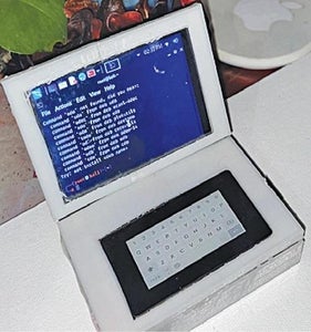

This project is built using Raspberry Pi and E-ink Display. When I found the smallest DIY E-ink Phone quite impressive, I thought why not try to make a laptop...
It has all the basic features compared to a normal laptop. Very small in size that I can carry it in my pocket….

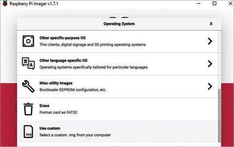

Before proceeding further, we need to prepare the Raspberry Pi board with Kali Linux. For that, go to Kali Linux’s official website and download its latest version for an ARM-based device like Raspberry Pi.
Next, download the Raspberry Pi disk imager and install it. Insert the SD card into the USB drive and prepare it with Kali Linux OS using the Raspberry Pi disk imager by choosing the Kali Linux OS image file in the Raspberry Pi disk imager.

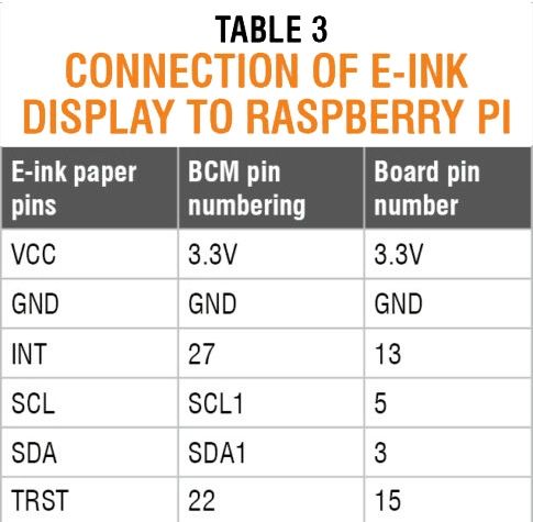

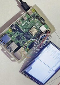

Step 4: Circuit Connections
Here you can check the connection between raspberry pi, e-ink display, and other components.

We need to program the keyboard to work accordingly and also need to set up Raspberry Pi and SPI Display. Moreover, I build my own OS.
For making the touch keyboard, we need to display the keys on the e-ink display. So, download a vector image having the keys on the keyboard. Resize the image to the size of the e-ink display, then download the library for the touch e-ink display. Here we are using the waveshare touch e-ink display.
