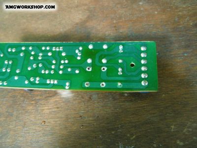

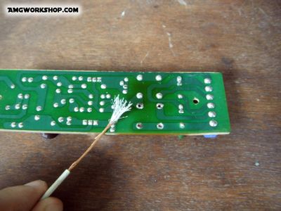

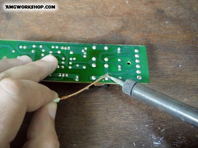

I wanted to share with you this trick i learned years ago when i was trying to clean some Pcb traces. One night while i was doing some electronics repair i found out that i run out of solder wick, because i don't use it that much i didn't care to have extra of it, so i grabbed a piece of copper wire, i smeared it with some flux and i use it as a solder wick and it worked like a charm.
Step 1: The Making

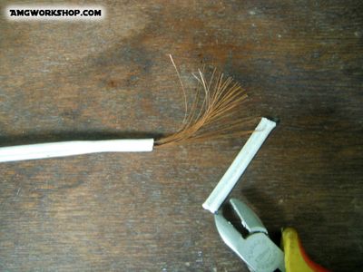

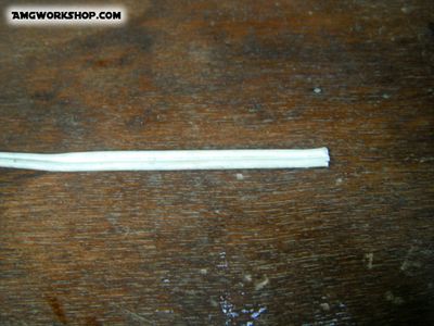

To make your own solder wick you will just need a piece of stranded copper wire and some flux.
  1. Strip the wire

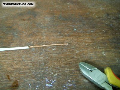

  2. Twist the wire to hold a straight shape

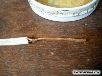

  3. Apply some flux to it
And now you just made a solder wick from a piece of copper wire, you can use it as the usual solder wick.
