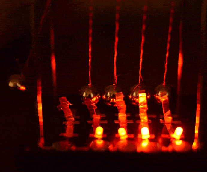

Additionally, I have provided 2 images of previous explorations. Let me know if you have any interesting explorations of your own!
