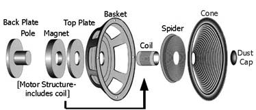

The cone's oscillations are fast enough to be considered vibration. This vibration produces the sound one hears from the speaker. The second diagram attached is from this speaker repair website. It is an exploded view that may help visualize how a speaker works.

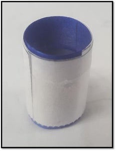

- Connect the magnets together to form one longer cylinder
- Be careful, the neodymium magnets are brittle and can easily break
- Wrap the blue strip around the magnet cylinder and tape it off
- This paper's ultimate purpose is to ensure a slip fit between the speaker coil and the magnet cylinder
- When magnetic field are close, they have a greater effect on each other. Keeping the coil's induced magnetic field close to the permanent magnet will enable the speaker to be louder
- Wrap the white strip around the blue cylinder and tape that off as well
- This creates two concentric cylinders, as shown in the first image

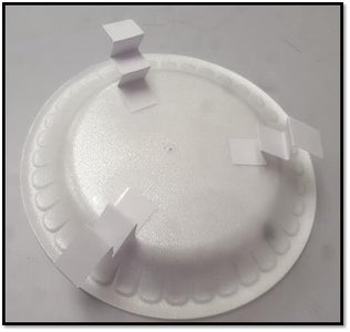

- Cut three strips of paper about 1" wide and about 5" long. Bend them into a zigzag shape
- These will support the cone and keep it standing up
- Hot glue the zig zags to the plate in the triangular pattern as shown in the third image.

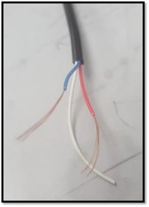

Step 5: Prepare Aux Cord
- Cut the aux cord in half
- Strip one end so the interior three wires are exposed
- Strip those three interior wires
- One is ground, two are signal
- Depending on your aux cord manufacturer their colors will change
- Use a multimeter to find this out
- Connect the ground wire to one lead of your speaker coil by twisting them together
- Connect one signal wire (your choice does not really matter) to the other speaker coil lead
- Solder the connections and cover them in electrical tape for strength
- Test your speaker coil using a multimeter on the continuity test setting on the 3.5 mm jack
- If there is a connection, the solder job worked!
- You can also measure the impedance of your speaker at the multimeter using its DC ohmmeter
- The leftover signal wire should be covered in electrical tape and will not be used
- This would be used to establish stereo sound with a second speaker if you want.
- If you do this, the ground wire would have to become a ground node between the two speaker coils and the aux ground wire
