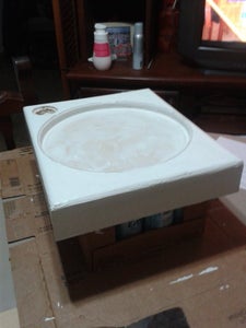

Step 2: Cutting and Gluing

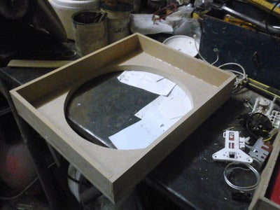

I started by buying mdf with the measures that I intended to make the tray and gluing

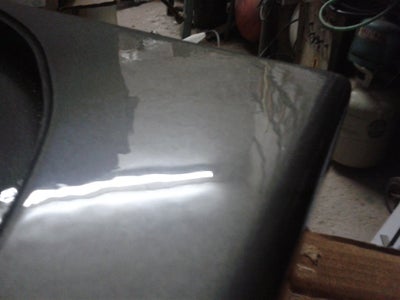

Step 3: Mashing
Total mashing to cover all imperfections and achieve a better finish

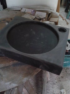

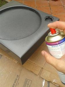

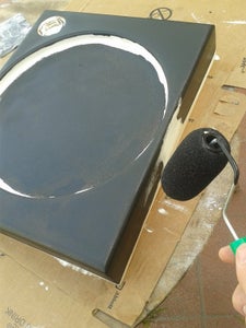

Step 4: Base Painting
Step 5: The Most Funny Step... : Painting

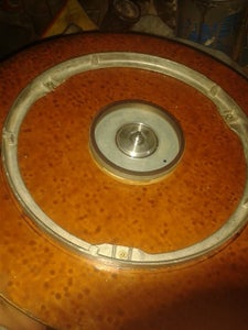

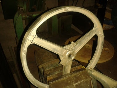

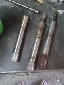

Step 6: Transmission
Placement of the pulley that will pull the plate. I used the pulley of a washing machine, I cut the part of the center and screwed the same to the plate, previously having marked with a compass the centered circumference.
The motor was extracted from a cassette player, has 4 pins, in two of which a potentiometer is connected to regulate the speed.
The strap, not getting the measure I needed, I cut a motorcycle camera and it was more than good.

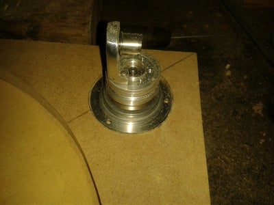

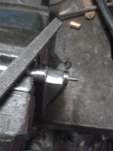

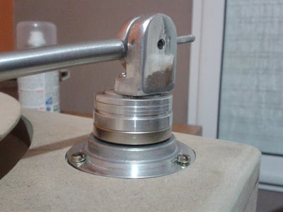

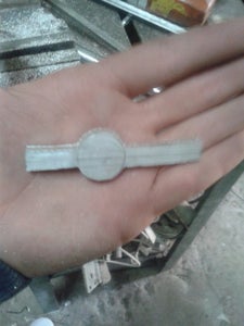

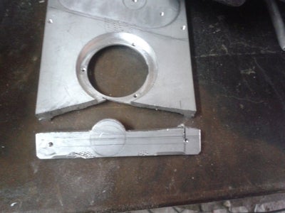

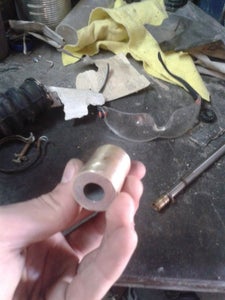

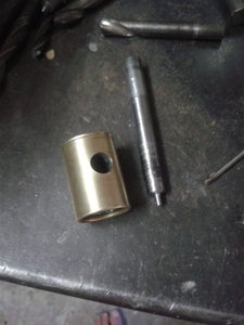

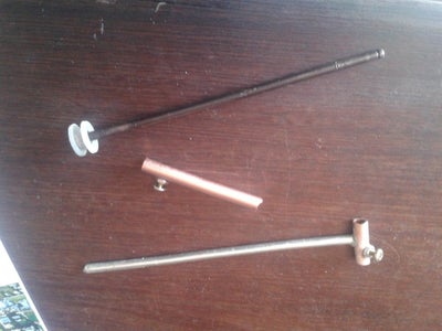

Step 7: Tonearm
I used aluminum from a computer hard drive chassis, trimmed and polished

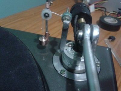

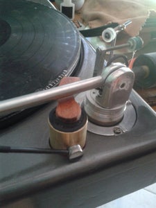

Step 8: Anti-skating System
Performing a basic anti-skating system. Mechanism that exerts a force contrary to that generated by the friction of the pick with the disc in the direction of the center, to allow a better reading of the groove of the vinyl disc

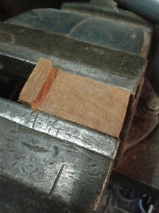

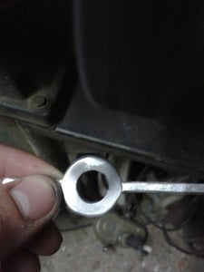

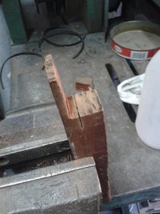

Step 9: Head
Made of wood for the cartridge

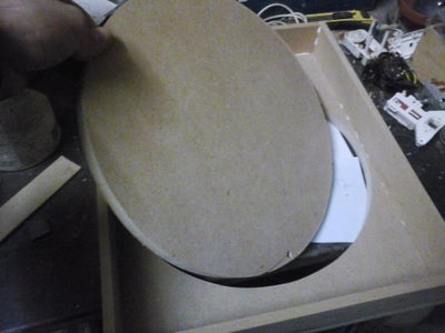

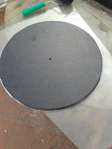

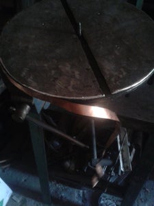

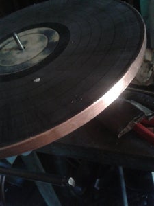

Step 11: Plate
To finish, I screwed to the plate some plates of lead that had at home, and to have a better view I placed a ribbon of copper in the edge of the plate:

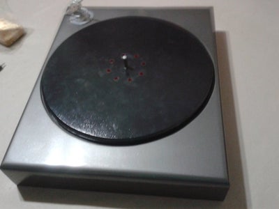

Step 12: And... the Finished Homemade Turntable
