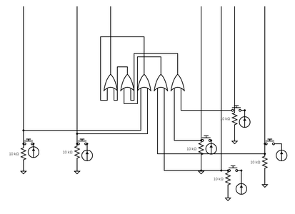

The controller is the input mechanism for the video game console.
1. Place 6 tactile buttons on the breadboard
2. On one side of each button, connect each button to the breadboard's ground rail with a resistor
3. Connect the other side of the buttons to the voltage rail
4.On the ground side of each button, connect the ground side to an OR gate
5. For each button, connect another wire to the ground side of the button, leave the other end of the wire open (it will connect to the Arduino later)
6. Connect the OR gates outputs into other Or gates inputs as shown in the diagram, for the final OR gate, leave the output open (it will connect to the Arduino later)

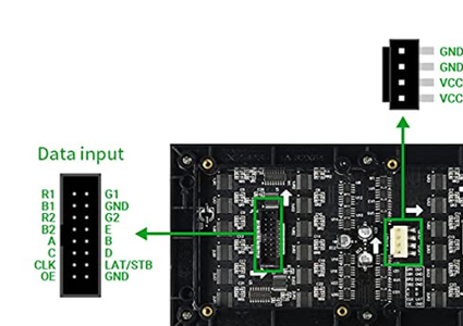

2. Wiring the LED matrix to the Arduino
The input pins on the back of the LED matrix are listed in order from left to right and from top to bottom.
r1 -> Arduino digital pin 22
g1 -> Arduino pin 23
b1 -> Arduino pin 24
gnd -> Arduino gnd pin
r2 -> Arduino digital pin 26
g2 -> Arduino digital pin 27
b2 -> Arduino digital pin 28
E -> Arduino digital pin 29
A -> Arduino digital pin 30
B -> Arduino digital pin 31
C -> Arduino digital pin 32
D -> Arduino digital pin 33
clk -> Arduino digital pin 34
lat -> Arduino digital pin 35
OE -> Arduino digital pin 36
