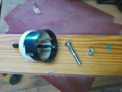

Step 1: Supplies/Materials
1) 3/4 inch peice of wood (I used plywood)
2) A drill press
3) A a 2 1/4 inch bore i think is what it is called with a drill bit in the center to get the axel centered (or pick your size)
4) A 2 inch bolt and locking nut (mine is a 1/4 inch bolt and nut)
5) Some sort of spacer for the center (a bearing is perfect but if you don't have one like i don't then a nylon fastener or the little blue spacers in k-nex sets work perfectly.
6) Yo-yo string (LeumasYrrep has a good instructable on this if you want homemade)
7) A sander, sand paper, or file to smooth edges (belt sanders work marvelously)
8) Two washers to go on the outside of the yo yo for stability

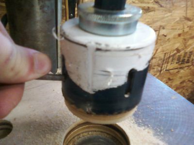

Step 2: Cutting the Circles
You need to attatch the bore to the drill press and just cut two circles out of the wood like in the picture. The wood will probably burn because of the hardness but thats no problem just go slow.

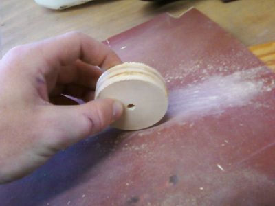

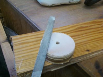

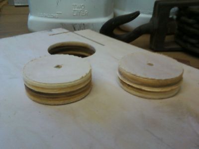

Step 3: Smooth Out the Circles
Here you are going to need to smooth out the circles using a file or sand paper or something. This is also where you choose which side is going to be facing in where the string is and which out. I picked the side with the prettier grain to be the outside. Now on the inside you need to round the edges off at more of an angle to that the string has kind of a rail to be fed into the center if it gets off balanced. Make sure there are no rough edges or splinter that could catch the string.
(On previous models i have sprayed the yo yo with laquer to give a slicker, smoother surface for the string to rub against and it makes it shiney. But I like the natural wood feel)
