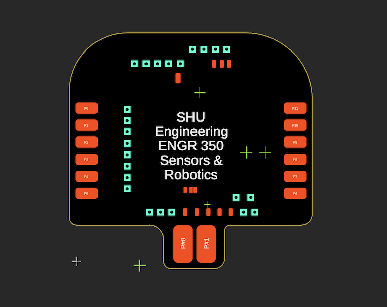

The picture shown is the schematic of the ESP32. I chose to solder this onto a PCB board for a smaller form factor. You could either do the same or keep the ESP32 on the breadboard.
The 3 wires that are sticking out of the breadboard are the power, ground, and data wires. The power and ground wires will be soldered into the adapter that comes with the power supply to power the clock. You can branch another wire off of these two and plug the ground, power, and data pins into the LED strip to power it.

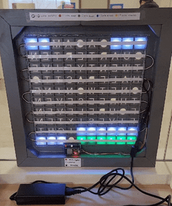

To begin, cut out a piece of diffusion gel to be the same size as the LED support grid. The gel listed in the PDF has two sides to it, a glossy one and a matte one. You can put a light behind it and decide which side you prefer facing up.
Sandwich the diffusion gel between the back of the face and the LED support grid. Apply hot glue around the edges to hold everything in place.
Next comes the LED strip. Bend the strip until it covers all the letters as shown in the picture above. Next, hot glue the strip to the LED support grid. This can be accomplished by making a hot glue bridge over the strip to hold it in place.
I used some extra scrap wood to create some supports for the ESP chip so I could hot glue it to the back of the face. You could do this too if you'd like.
I finished by hot gluing any extra wires down so it would look nice from behind.

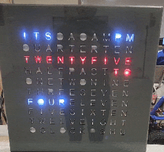

When you first plug in the clock, it will automatically attempt to connect to the internet and set the time. If you'd like to sync the clock with WiFi later, you can push one of the three buttons to do so (for me its the red button). If the clock is not able to connect, it will time out automatically and you'll need to set it manually.
The other two buttons adjust the hour and minute values. I made some signs on the back of the clock to specify what each button does and what each color means.
