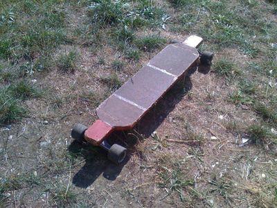

I made this longboard a year ago and decided to show you how did I made it. This board is not flexible at all, and it's heavy, but it would be the real challenge to break it. The wood which I took is Oak, it's great wood for construction because it is hard and firmly.
Main goal of this board is to lower your center of gravity so you'll be more stable.

When connecting parts it is good to use some wood glue, look at the pictures where and how many screws did I used, I didn't drew all screws in schemes. You can also find CAD files down below.
All I can say is that this longboard is very stable and fast, it really surprised me.
