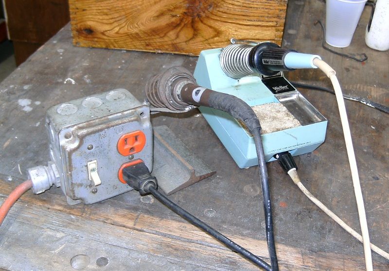

14 years ago
I have also made something sort of like this. You can see it in this image:
http://home.comcast.net/~pcf1/DesolderBench.jpg
I used some sort of a spring and wrapped a strip of sheetmetal into the spring, welded that to a 1/4x20 bolt then welded a 1/4x20 nut to a scrap of steel I welded to an 1900 box I wired with a receptacle and a switch, to switch the lower outlet. I went with antislip rubber feet too.
I still should put a pilot light into this thing someday.
Now that I picked up a Weller station at a flea market I use that more.
I'm stripping some boards in that picture. That pot works really well for tinning iron tips too. Or tinning plumbing fittings, or what have you. Whenever you need 5 pounds of molten solder I guess.
