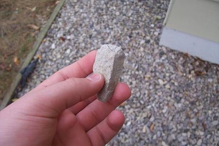

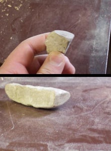

Step 1: Find a Limestone Rock
Find a cool rock that kinda looks like this. I don't know if you can see this but it's
*kind of* shaped like a 3 faced pyramid with a *kind of* flat base. I'm holding the rock with the base facing up.

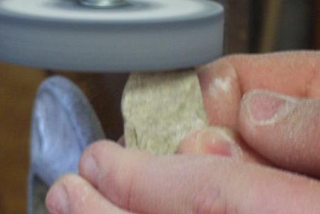

Step 2: Refine the Base
Stick the grinder in the drill press and grind the *kind of* flat base into a *really smooth and shiny* flat base.

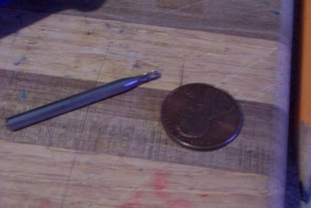

Step 5: The Tool
This is the Dremel bit I used. It's an endmill.

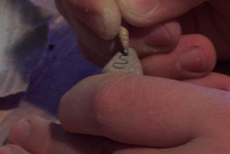

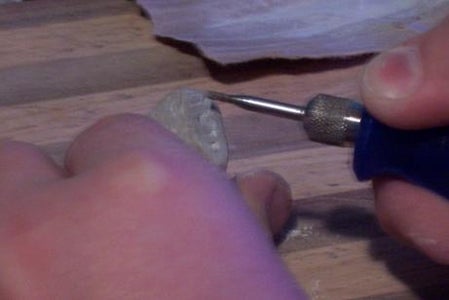

Step 6: Carve!
GENTLY carve out your design with the funny broken drill bit thing. The deeper you carve the better.

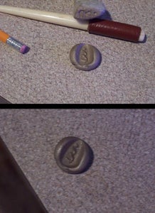

Step 7: Fine Tune
Use a piece of clay and test it. if it looks great then you're done with wax seals part 1. I'll make part 2 when I have nothing better to do.
