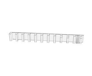

 - 3D printed turn-styles or gates

    why doesn't the stl file for the turnstiles come out the size required? surely it should be the length of the pcb? whereas it is barely mm in size!
    0
    DylanC11
    DylanC11
    Reply 5 years ago on Introduction
    Solution: Scale every dimension by 25.4 (which is the conversion ratio for mm to in)
