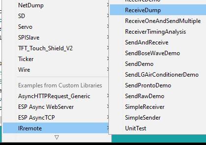

For this step, open the Arduino IDE and if not already installed, install the IRremote library (https://github.com/Arduino-IRremote/Arduino-IRremote) This should be listed in the IDE as the one from Armin Joachimsmeyer.
I would highly recommend reading the documentation for this library to understand the extensive capabilities of it.
Once installed, attach the arduino to your computer, set the board and port values that match your board.
Go to File->Examples->IRremote and load the ReceiveDump sketch.
This is basically ready to go, but you might need to define the IR_RECEIVE_PIN to match whatever pin you chose to use. There are defaults if not defined in the sketch, and the library documentation has all the info. However, it's just as easy to use your own choice:

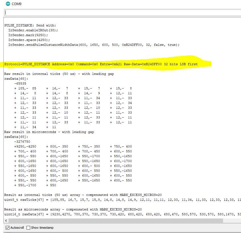

You should see some text on the screen. If it is constantly streaming data out, then check the connections and the pins for the diode. They can be very sensitive to electrical noise caused by flakey wiring on breadboards.
If you clear the monitor screen, point a remote at it and press a button, it should stream a new block of data out. The onboard LED should also react to a button press.
Not all remotes use a protocol that is supported by this particular library, but not all is lost...read on.
Step 3: Collect Your Remote Codes
This is where your choice of buttons becomes important. You will be creating a web-based UI that will be displayed on everything from laptops to mobile devices, so think of that and how many buttons you want to squeeze into that viewable space. Lets collect your first code.
Clear the monitor output, point your remote at the Rx and press the button for about the same time you would normally. Most remotes send a lead-in code, the command code and a flag to say "here endeth my code", a short pause, then repeats the transmit sequence. This is so the Rx does not 'see' a stream of data back-to-back and cannot work out what it's saying.
With luck, you will see a line similar to that highlighted in the screenshot. It may be a different protocol(This one is "NEC")
It may take a couple of attempts to get a properly decoded value, so if it looks like this:
Result as internal ticks (50 us) array - compensated with MARK_EXCESS_MICROS=20
uint8_t rawTicks[3] = {182,45, 11}; // Protocol=NEC Address=0xFD01 Command=0x8A Repeat gap=96850us

..try again and it should produce this..
uint16_t address = 0x5343;
uint16_t command = 0x1;
uint32_t data = 0xFE015343;
..if not, look way down the end of the long lines
Result as microseconds array - compensated with MARK_EXCESS_MICROS=20
uint16_t rawData[67] = {9080,4520, 530,570, 530,620, 530,1670, 580,570, 530,570, 580,570, 530,570, 530,620,
 530,1720, 530,1670, 580,570, 530,1720, 530,1720, 530,1720, 530,1670, 580,1670, 580,570, 530,570, 580,570,
 530,1720, 530,570, 530,570, 580,570, 530,570, 580,1670, 580,1670, 580,1670, 530,570, 580,1670, 580,1670,
 580,1670, 580,1670, 530}; // Protocol=NEC Address=0x4 Command=0x8 Raw-Data=0xF708FB04 32 bits LSB first
You are looking for the "Raw-Data" value or the "uint32_t data" value.

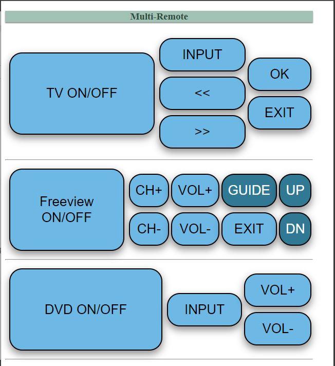

Now we build the code for the webpage, including some styling and a javascript function to handle the buttonclicks. To send the right device index number to the handler, we store the index as an easy-to-remember variable name. The first line allows for creating all the HTML, CSS and javascript code into a single variable that can be used anywhere in the sketch. It reduces a lot of Serial.print and quote escaping code.

..buttons and layouts
div class="btnBig"><table width="100%" border="0"><tr>
   <td class="bigCell"><button class="btnMain" id="lgtv_onoff" onClick="sendIR(lgtv,0)">TV ON/OFF</button></td>
   <td class="smallCell"><button class="btnSub" id="lgtv_src" onClick="sendIR(lgtv,1)">INPUT</button><br>
   <button class="btnSub" id="lgtv_selLeft" onClick="sendIR(lgtv,3)" width="45%"><<</button><button class="btnSub" id="lgtv_selRight" onClick="sendIR(lgtv,4)" width="45%">>></button></td>
   <td class="smallCell"><button class="btnSub" id="lgtv_OK" onClick="sendIR(lgtv,2)" height="100%">OK</button><br><button class="btnSub" id="lgtv_Exit" onClick="sendIR(lgtv,5)" height="100%">EXIT</button></td>
   </tr></table></div><hr>
These are the buttons for the TV, and uses the onClick event to send the device name(transposed to the device id) and the button index. It uses a mix of CSS and inline styles to control the layout. By far this was the most time consuming part of checking the layout, modifying and testing the new look.

Open a browser and enter http://[ip address of ESP]. If you don't know what it is, uncomment line 147, upload and restart the ESP with a monitor console open. Alternatively open your router configuration interface and check the DHCP leases, which would also be a good chance to create an IP address reservation for your ESP.
All going well, you should see this..or your version of it
