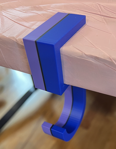

Step 1: Measure and Adjust the Design
Every desk and table is a little different, so customizing the design ensures a snug, supportive fit.
Start by identifying where you’ll use the hook most often—your classroom desk, kitchen table, or office counter—and measure carefully.
Steps:
  1. Open the attached STL file (Hook Version 5.stl)
  2. Use a tape measure (or a ruler if that’s all you have) to measure the surface thickness.
  3. Compare your measurement with the default STL size (1.25 inches).
  4. If your desk is thinner, the hook will still work, but grip may feel looser.
  5. If your desk is thicker, adjust the STL in your slicer:
  6. Scale only the X-axis to widen the clip.
  7. Leave other dimensions the same to keep structural strength.
  8. Export the model for printing!
Tip: Always test with lightweight items first after resizing—structural integrity changes slightly when you scale.

Step 2: Slice and Print
Now that your design is adjusted, it’s time to set up your print. Good print settings make the difference between a weak, bendy hook and a durable one.
Recommended Print Settings:
  1. Infill: 50-60% (adds strength while keeping print lightweight)
  2. Supports: Not needed in this design
  3. Print time: ~35-40 minutes depending on your printer and size
Steps:
  1. Import the STL file into your slicer.
  2. Adjust scale if needed (from Step 2).
  3. Preview the model to confirm the design is positioned on the bed sideways. This positioning is what allows us to avoid the use of supports.
  4. Save the sliced file. For my setup, I saved it onto an SD card and inserted it into the printer, but be sure to follow the file transfer method required for your specific printer.
  5. Begin the print!
Tip: Before printing the full design, try printing just the desk attachment piece to confirm it’s the right width and fits your desk properly. This way, you won’t waste time and filament on the entire model if adjustments are needed. I’ve also included a separate STL file (Hook Part.stl) with only the desk attachment part for easy testing.

Step 4: Post-Processing and Assembly
When the print is finished, it’s ready for some quick finishing touches.
Steps:
  1. Gently remove the hook from the print bed. Avoid bending it too hard to prevent cracks.
  2. Optional: Add grip material (rubber/felt) to the inside of the clip using super glue.
  3. Test the hook on your desk. It should sit flush and feel stable.
  4. Start with lighter items, then gradually test heavier loads (product supports about 15–20 lbs).
