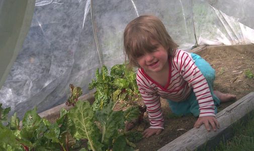

Now you should be able to have fresh veggies all year long.
Here are a few pointers.
- Use lots of manure and compost, since you are using the soil all year, it needs to be replenished. In France, they use fresh horse manure to heat the green houses. Try it if you got it.
- Don't forget to water! Plants that are covered don't get the rain. (some goes through the cloth, but none through the plastic) We have two big rainbarrels next to our beds, and we use them year round. We make sure they are close to empty if we are getting super cold weather, so they don't burst from ice.
- Plant a lot of seeds! Seeds are cheap, take a chance, try different things at different times. The worst that happens is they don't grow. The best is you have too many delicious veggies.
- Write it down! Label what you plant, make a map, make a chart of when you planted things. This will help you year to year, learning what works, and what doesn't. Also this helps you remember what you planted where. Spring came this year, and I couldn't tell the difference between my broccoli, kale, and kohlrabi for a while.
- Have fun! Let the kids help! They love playing in the hoop houses, they're good at weeding, and it's great for them to learn about their food.
