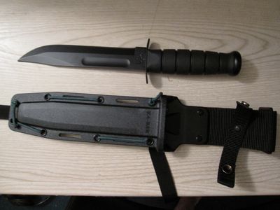

This instructable will show you how you can make a cheap horizontal sheath using any of the all-purpose ones that are traditionally oriented vertically but have the holes and belt slots available. It will be stabilized on its own belt. If your sheath does not have these holes but has room, it seems like it would be easy to drill them out so long as you are certain that doing so will not make the sheath fall apart. However, this is beyond the scope of this project.
I began this project after seeing a few people wearing their survival knives against the small of their back in the horizontal position. It can sometimes be a nuisance when you are out camping or backpacking and you have a larger knife hanging vertically below your belt, flopping around and sometimes hitting your leg when you walk. This was especially the case with my newly purchased Ka-Bar. It has a 7" blade, full length over 12". Aside from this, it is a more natural motion to withdraw the knife in this position, as your hanging arms and hands are already comfortably aligned with how you take out the knife. These are all little details that can often make the difference between a so-so experience and an enjoyable one.

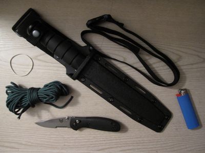

Step 1: Materials

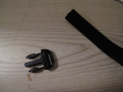

You will need the following:

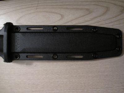

1) Sheath that has the holes around the edge
2) 40" x 3/4" Webbing Strap with side-release buckle ($2.50)
2) 40" of nylon cord or paracord ($4 for 50ft)
It would also help to have:
1) Lighter
2) Rubberband or twist-tie
3) Fork to undo and retry stopper knot
The nylon cord and strap can both be bought from REI or any other outdoor type store. 40" webbing strap because I am a size 32" waist. Go bigger if you will need a bit more to function as a belt.
The strap will be used as the knife's independent belt. I tried other designs where you could just feed the belt you were wearing through it, but the sheath would slide around, which made it difficult to locate the knife (a big no-no!) and made it difficult to both draw and resheath the knife reliably.

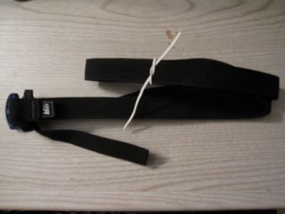

Step 2: Prepare Materials

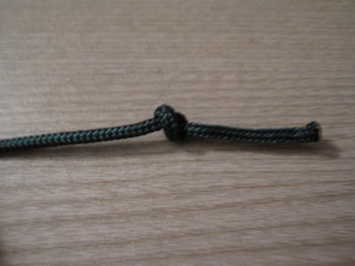

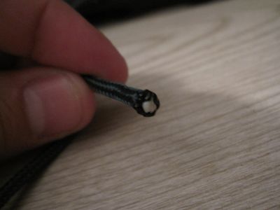

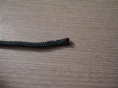

1) Cut about 40" of nylon cord. Depending on the size of your knife, you will likely use about 1/2 of this but it can be hard to gauge just how much you'll need.
2) Use the lighter to melt the ends of the cordage. Do this on the now free piece and also on your bundle if you cut it from a larger source. This prevents the ends from fraying and coming apart.
3) Put your belt on and find where you want your knife to rest. I did this by first tightening the belt to a comfortable fit. I then placed the back of the sheath against my back with the handle sticking slightly out from my right side. This makes it easy for a right-handed draw. Switch sides if you would like a left-handed draw.
4) Mark a reference spot on the belt with the rubberband or twist tie. The single place I chose to mark was at the junction of the blade and handle. This is just for reference and is only useful in making sure you place your knife exactly where you want it.

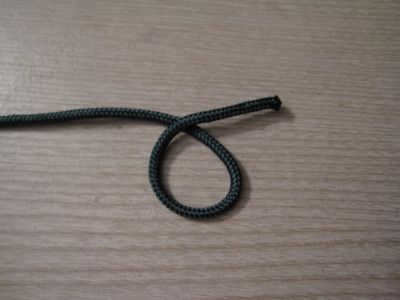

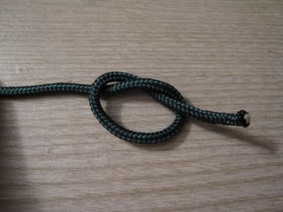

5) Create stopper knot on one end of nylon cord. I used a simple overhand knot. It is more than sufficient to hold the weight of the sheath and blade. The pictures will show how, or you can look here for more pictures and steps on the overhand knot, or other more secure knots such as the double-overhand or the figure 8. Notice that I left a little extra at the end, this is intentional and is a good safety precaution. If you cut it to close the knot may unravel. We can clean up at the end!

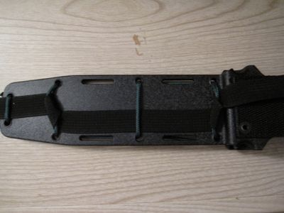

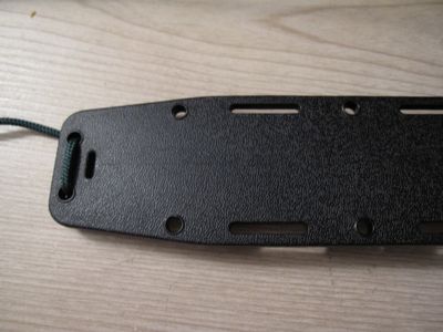

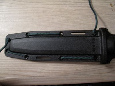

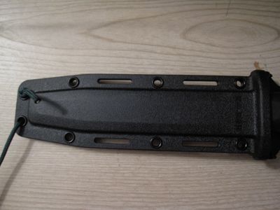

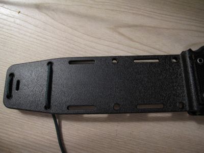

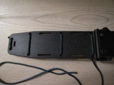

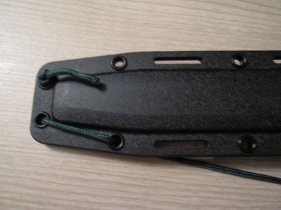

Step 3: Thread Sheath for Horizontal Orientation
1) Look at the first picture. This is the goal. As long as you get here you should pretty much be ok.

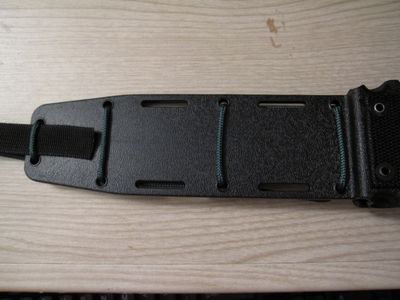

2) Thread cord starting at the tip of the blade. Place your sheath with the top on top. Thread the unknotted end down into one hole and then across the gap perpendicular to the length of the blade. This is to create a loop for the belt.
3) Thread to the next hole parallel to the blade, then jump across again, creating another belt loop. See pictures if this seems confusing.
4) Rinse and repeat. Get in as many belt loops as you can, this will help to stabilize the blade, although attaching our belt in a special way will immobilize it, so it may be unnecessary to do more than a few.
5) Pull nylon cord tight and attach another stopper knot. This will keep our new loops in place and help to secure our sheath. Try to knot the last stopper as close to the sheath as possible to minimize slack. It can be tricky to get it close. Just take your time and maneuver the cord until you get it close. If you mess up, a fork can help you undo the knot to try again.

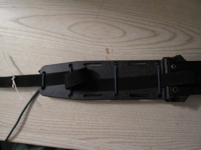

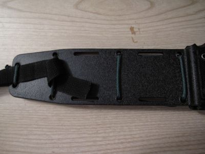

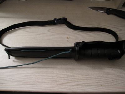

Step 4: Attach Sheath Securely to Belt

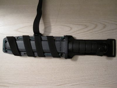

1) Figure out which way the belt should be going through. The first picture will show you how I set up mine so that I could visualize it and be sure it was right. If you do it wrong your buckle won't be right and you will have to flip part or all of the belt to clip it together. This can be very annoying and you will just have to fix it by redoing this entire section.
2) Take off the male part of the buckle. This will make it easier to attach the belt if you don't have to worry about a huge hunk of plastic.
3) Feed the loose strap through the first loop. Start at the tip of the blade.
4) Wrap strap around the second loop. We need to wrap the strap around two loops to immobilize it and prevent it from sliding around. I chose the second and fourth, and recommend you do the same, one at each end. This will distribute the weight of the knife and sheath evenly. I could not do the first loop because it is too small to wrap around. First pass under the second loop, then wrap it around and continue forward.
5) Keep it loose and keep moving forward under both the 3rd and 4th loops until your reference point is in position. Do not wrap around the 4th until you get that marker in line. I took off the rubber band and just held its spot as I moved it along.
6) Now wrap around the last loop and pull tight.
7) Reattach male part of buckle.
