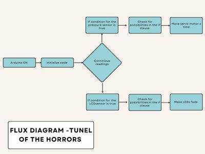

Step 1:
We design and create the code to run all the actions we are looking for in our horror tunnel with the following code
+ we add flow chart that we made
