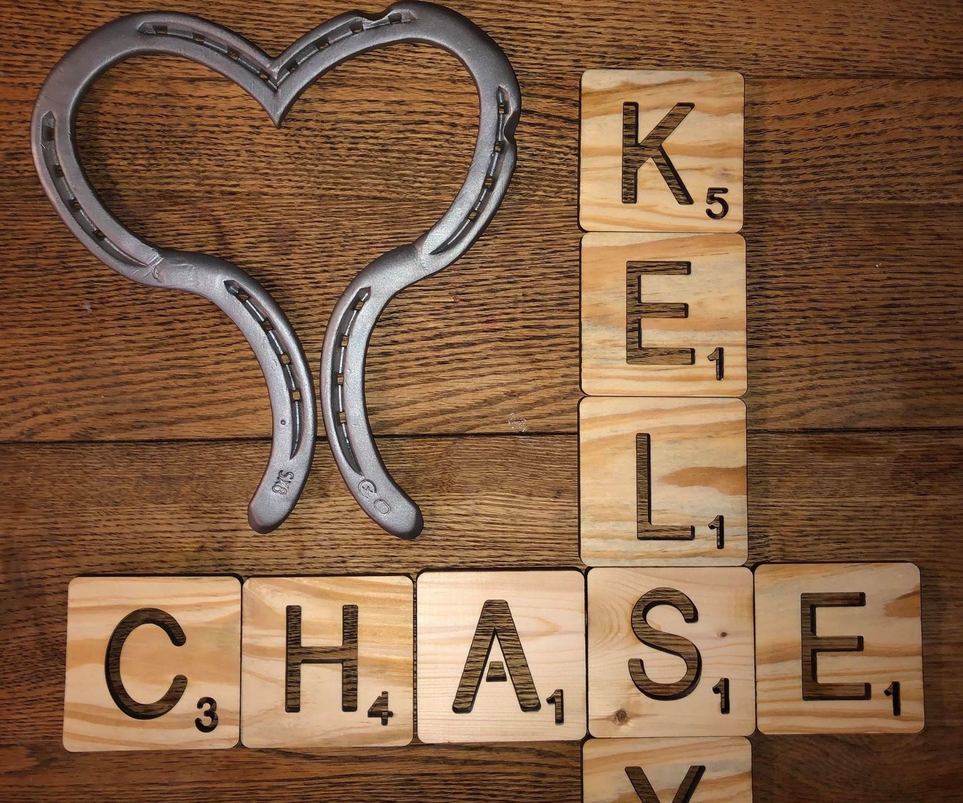

If you remember from my last 'Ible with the horseshoe heart, my roommate has a TIG welder but wouldn't let anyone else touch it. I must have won his trust a little bit, because now he's letting me use it a little bit myself. Other than the joints between the base and the trunk, the rest of the welds on this tree were done by yours truly.
