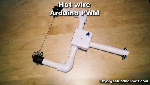

Last time I did the Hot wire foam cutter but I missed the temperature control. So that's why I made a simple PWM control. The whole project was based on Arduino ATtiny85 Digispark. For this project I only needed three pins, so the ATtiny85 is fine. Also I carried the wires in the PVC pipes. This article can also see here:

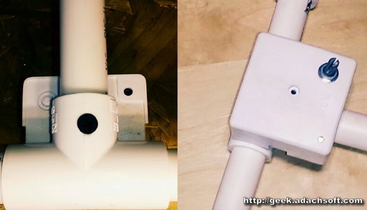

Step 3: Fixing
After soldering the circuit, we can mount it to the PVC pipe.
Step 4: Wires
The next step is to place the wires inside the PVC pipe.

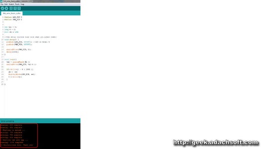

Step 5: Software for the Controller
The software itself is very simple.
#define LED_PIN 0
#define PWM_PIN 1
int val = 0;
long t = 0;
bool sw = LOW;
//the setup routine runs once when you press reset:
void setup() {
pinMode(LED_PIN, OUTPUT); //LED on Model B
pinMode(PWM_PIN, OUTPUT);
analogWrite(PWM_PIN, 0);
delay(1000);
void loop(){
val = analogRead( A1 );
analogWrite(PWM_PIN, val/4 );
if( millis() - t > 1000 ){
sw = !sw;
digitalWrite(LED_PIN, sw);
t = millis();

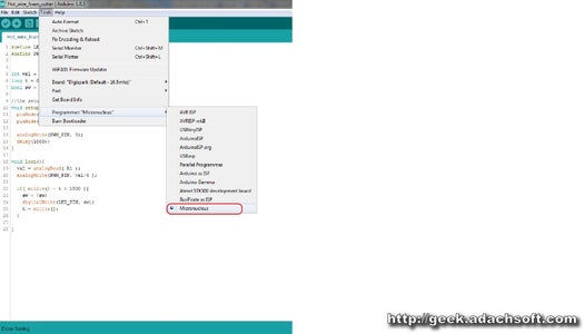

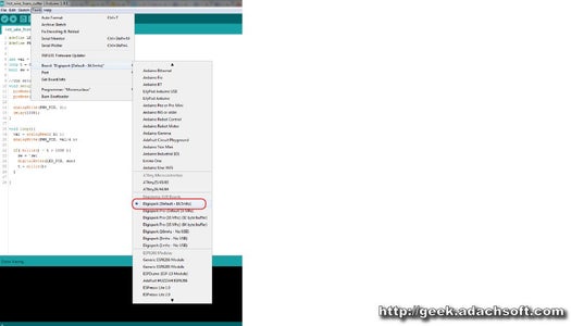

Download source code: Hot_wire_foam_cutter.inoStep 6: Programming ATtiny85 With Arduino IDE
- Select board digispark (Default - 16.5mhz)
- Select programmer micronucleus
Press upload and connect ATtiny85 Digispark to USB. You have 60 seconds to do it.
Wait until it's over
Step 7: The End
Work finished time to test Hot wire. Soon it will be Easter, so I will cut out Easter bunny.
