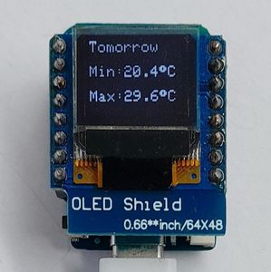

If you want to know which temperature is coming to town, take a look at this little device. it shows you the minimum and maximum temperature expected tomorrow in your hometown. Nice!

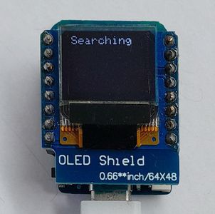

The program first searches to connect to your WiFi, then loads at open-meteo.com the temperature data from tomorrow and sends this to the OLED screen. This will happen every hour. You can also press the reset button on the Wemos d1 mini and the search will start directly.
