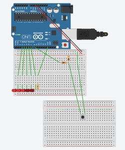

Step 2: The LEDs
For the breadboard, remember you will use pins 3 through 7. Put one end of the wire into each of the corresponding pins and into the column e. Line up the positive ends of the LEDs(anode) in column d and the negative ends of the LED. (Please ignore the black and red long wires in the top right-hand area).

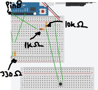

Step 3: The Push Button, LED Resistor, and Power
Using the picture above as a reference, wire up the resistors, wires, and the push button. Follow the diagram to see where to wire up the resistors.
- Place the push button on the other breadboard so that the two unconnected parts are parallel to the short edges of the board
- Take a wire from pin 8 to connect to the 1k Ω. Take the 10k Ω resistor from (+) column nearest to column j to meet up with the 1k Ω resistor in the same row.
- Then, take a wire from the location the two resistor meet to one end of the pushbutton. Take a wire from the other unconnected part to the (-) column nearest to column j
Very Important:
- Using the 330 Ω resistor, connect the column where all the cathodes of the LEDs are line up to connect with a ground(GND) pin
- To supply power to the board, connect a wire from the GND to the (+) column near j.and a wire from the 5V pin to the (-) column.

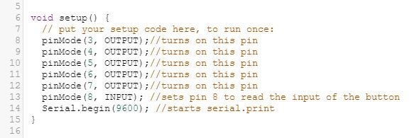

Step 5: Programming Part 2
Now we talk about the void setup portion. This section is only run once.
That is why we basically turn on the all the pins in this section. Further examination of the pictures will show you we put in Serial.begin99600) to establish the beginning of the program.

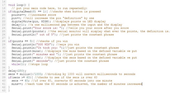

Step 6: Programming Part 3
We proceed to end with the final part of the coding, the void loop. This can be seen as the longest part of the code since the information forms the majority of the program.
Read the code and the comments to create the code or a variation of it.
