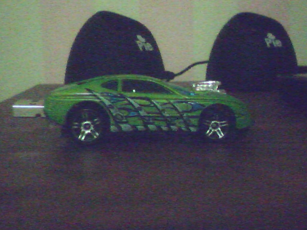

This Instructable will show you how to take a simple hotwheels car, and turn it into the coolest flash drive ever!

Now you need to cut a hole the size of the flash drive in the back of the car. Measure the usb connector and then measure the end of the car. I used masking tape to cover the part I didn't want to cut. Use your Dremel with the drill bit to cut a hole. Then I used the tungsten carbide cutter (product # 9901) to open the hole to the right size and shape. You want this to fit as snugly as possible.

Before you glue it all in, you want to dry fit it first. You want to make sure all the parts fit together. Take everything but the bottom with the wheels, and assemble it with the USB sticking out the back. Then attach the bottom of the car. Make sure everything fits right. The flash drive might not fit the first time. If it doesn't fit, make little adjustments until everything fits properly.
