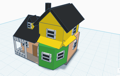

Step 1:
I added cream colored a box 37 by 40 box with a height of 20 and then attached to the corner I added a 31 by 26 green polygon with a height of 20.
On top of the polygon I added a 21 width and 38 length yellow box with 16 height.
Add a 26 width and 46 length 16 height roof on top of the first box and add a 6 by 6, 13 height box inside of the roof. Place a 6 width 7 length 15 height roof on top of the small box.
Add a 21 width 38 length 10 height roof on top of the yellow box
Create 2 black boxes with 15 width and 40 length on both sides of the roof.
Add a thin box that covers the entire bottom of the house to serve as a floor.

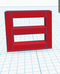

Add windows and a door around the whole house
All measurements of the window are 3 width 13 length and 1 height.
Door is 7 width 0.01 length and 14 height
Add a 5 width 5 length 14 height polygon in between the roofs and make it black.
Add small roofs going into the yellow box on both sides.
Step 3:
Add small rectangles connected to each other on the porch of the house to make a fence.

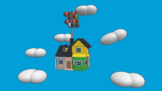

Make spheres into an oval shape and bunch them together with different colors
Copy it a couple times, place them over each other, group them, and place it over the chimney with a thin grey box to serve as a string.
Step 4:
Group everything together.
Move it all up.
Make the background blue and make white spheres overlapping each other to make clouds.
