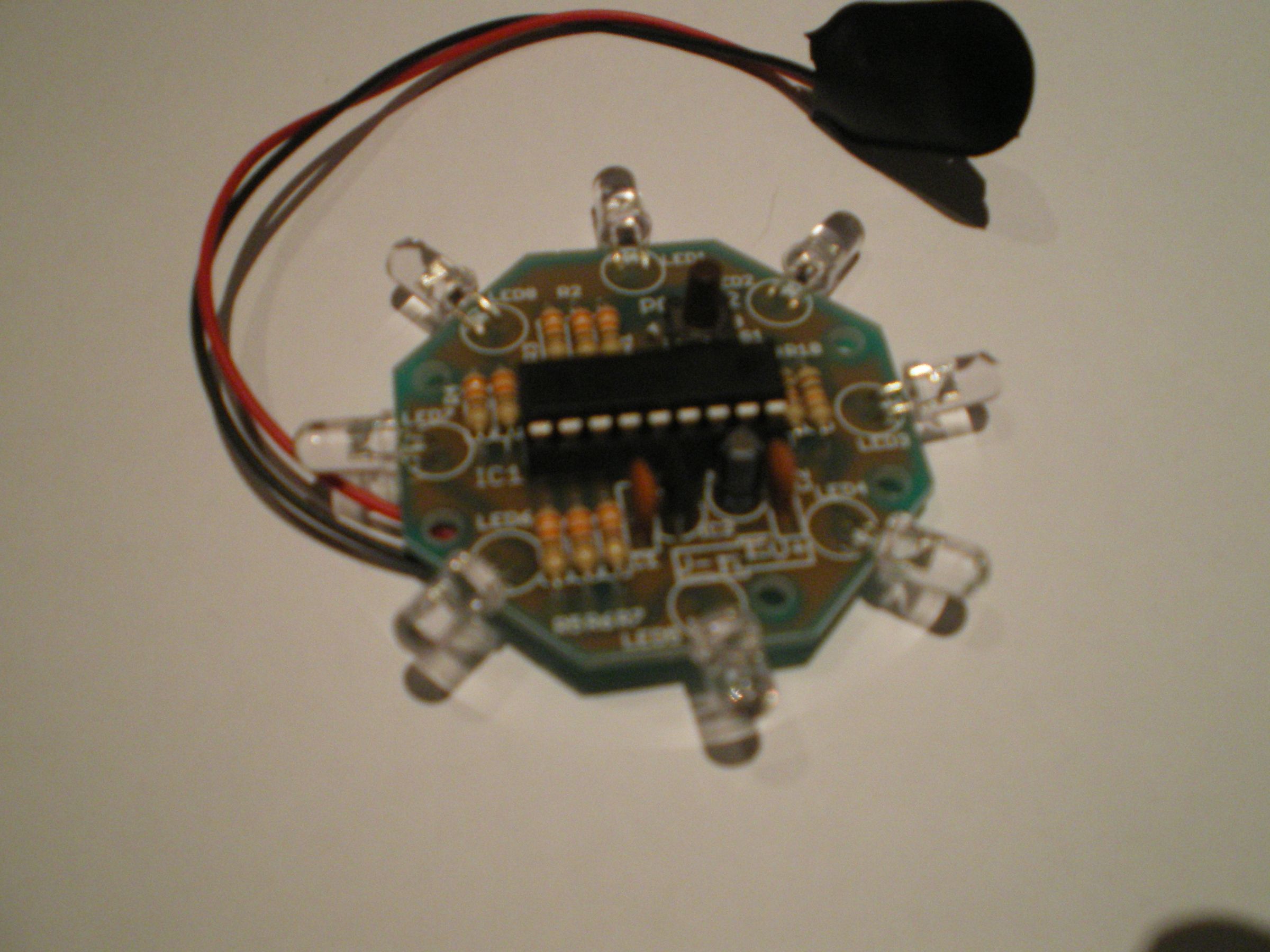

The black battery box contains the inverter... This circuit steps up the 3 volts to several thousand volts as this is how the wire works. The Phosphor in the wire glows when you apply a high voltage through it. This in turn will consume battery power to only work for four or five hours. I converted my unit to work on a mains adaptor from 220 volts to 3 volts. By adding a circuit that will switch off the 3 volts on and off every second. One can add a switch to turn the the number into "Flashing mode". This in turn will flash the number on and off every second making it highly visible to visitors or emergency services to find your home.....
One can buy a kit from various suppliers to provide the flashing mode as I did. No need to go into detail as there are many kits on the market to day that can be used.
