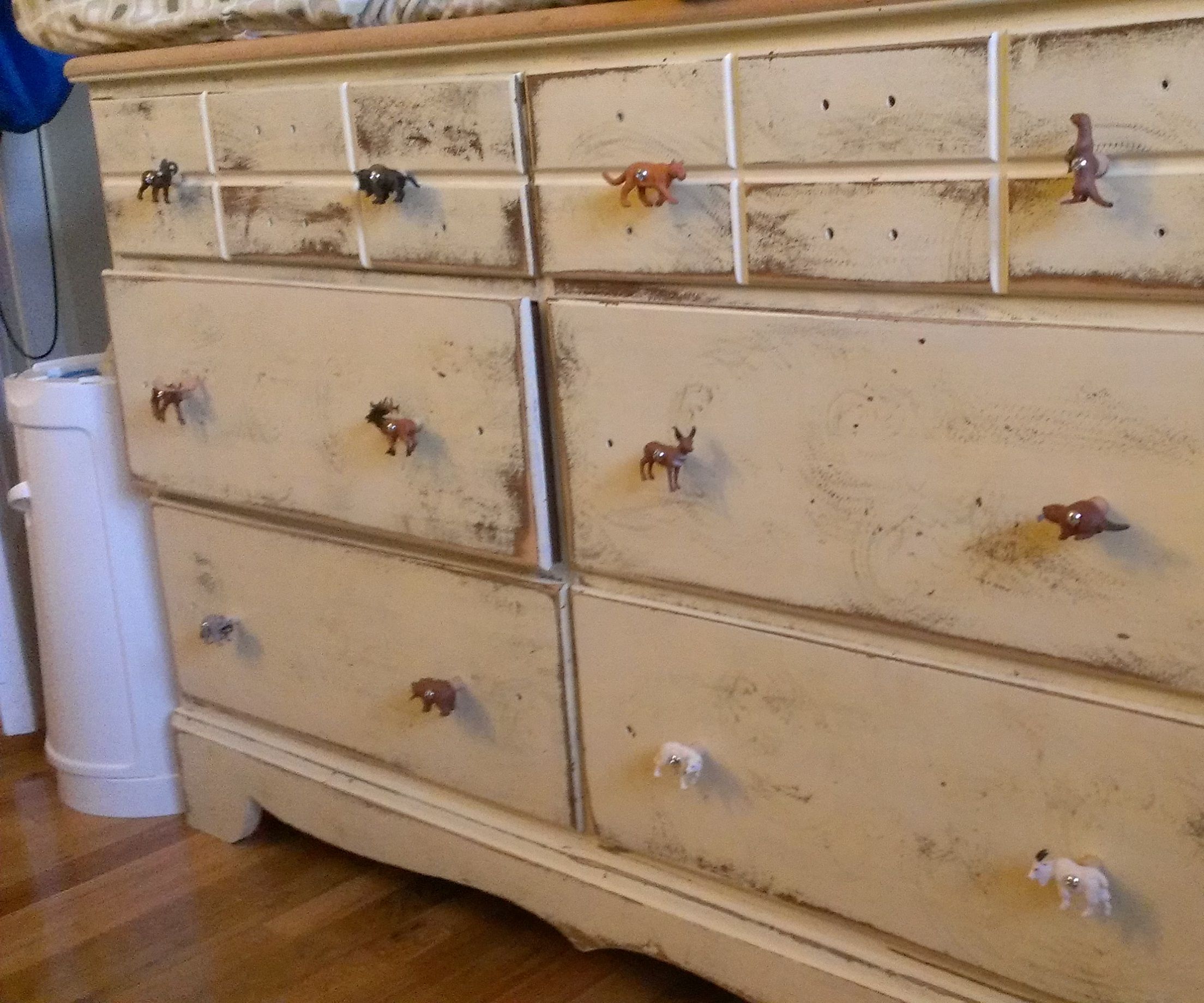

The new house is big enough to have a proper wood shop (double car garage, it's the american way...). So naturally I made a practice run on my new 110v, Inch based, american power tools building a new cage for Stella. It was made for the living room so had to resemble a piece of furniture, not a makeshift plywood box. I got to practice "frame and panel" cabinet making techniques on my rabbit's expense. I made my mistakes and learned some valuable lessons building this one. Stella doesn't complain. Here's the result.
