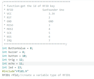

Step 4: Coding (variables)
In order to start off the code, I needed to initialize/define my variables. Doing so will allow me to control the pins of the Arduino and control what specific components will do. Here is the file to the code.

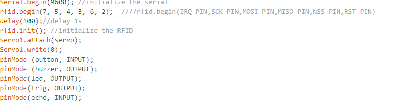

Step 5: Setup Function
After setting up and defining the variables. We now need to set each component to either input or output in order to actually connect it to the pin. For example, I have the button set to input because it will take the value from when someone presses on the button. Then, I had the buzzer set to output because when the button takes in the value, the buzzer will output a sound.

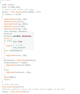

Step 6: Loop Function
The first step is to code the distance sensor with the led. The first section of the code will work as the following; if the distance is less than or equal to 5 inches, then the led will turn on, however, if the distance reads more than 5 inches, then the led will stay off. In addition, if the button reads high (stating that it has been pressed), then the buzzer will read high as well producing a sound that will act like a doorbell. Moreover, through the RFID code, when the card is tapped (value is read) then the servo motor will start to rotate 90 degrees, however, if the card is tapped again, the servo motor will rotate back 90 degrees.

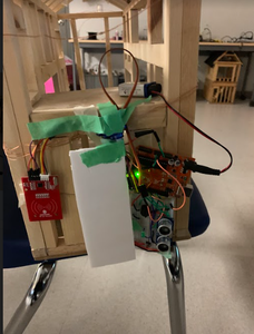

Step 7: Step Seven
Attach a cardboard/paper onto the servo motor in order to test if the system/project works as intended.
