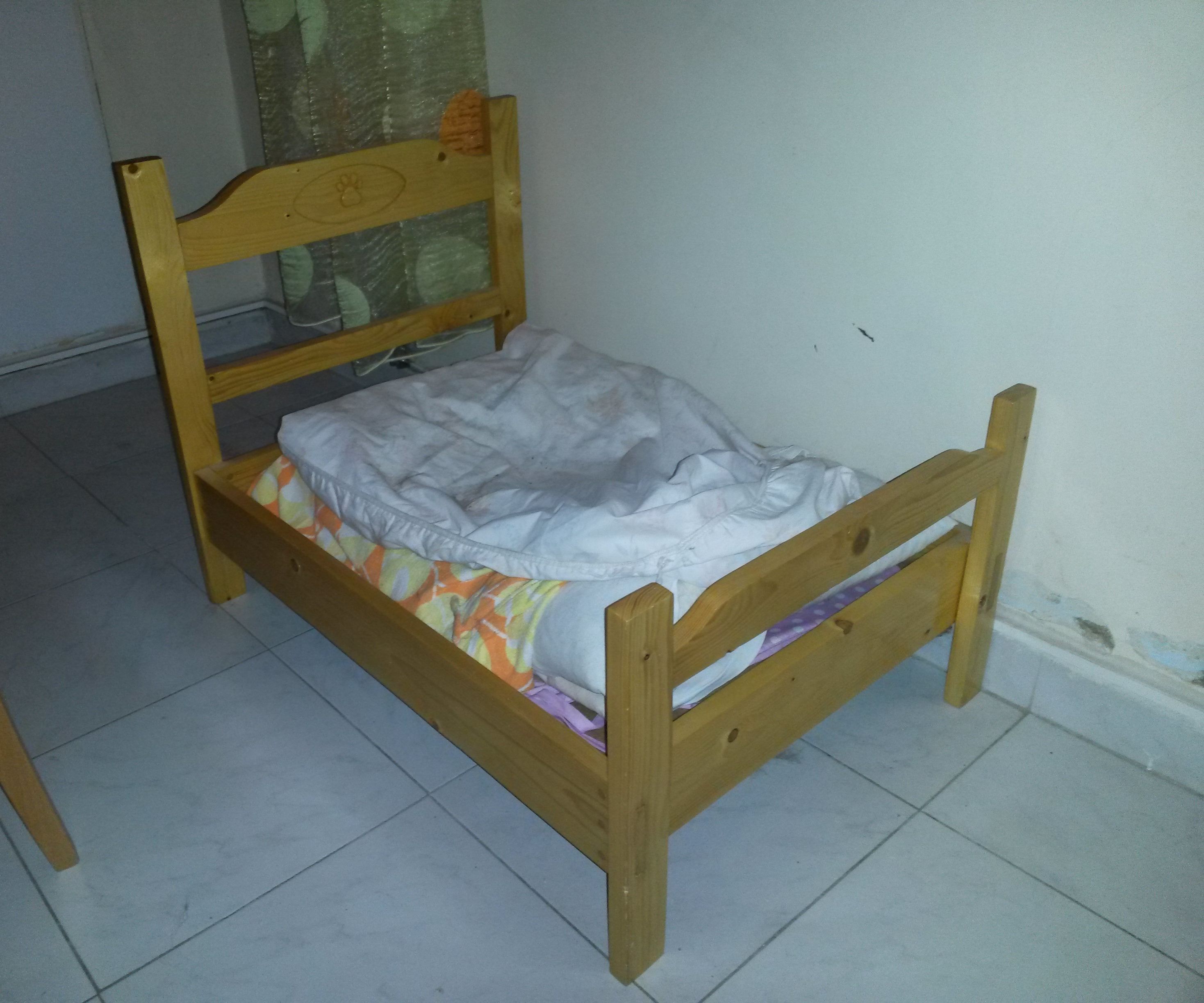

Step 1: Disassembly the Old Bed
The donor was something similar to the bed in the photo (R.I.P.). First Ι had to detach the side boards from the headboard and the footboard. Then I unmount all the hardware and remove the rails from the sideboards and any nails left.
Now comes the most boring part of the project. SANDING. I took my sander and with a lot of patience and a 36 grit sandpaper I started to remove the old varnish from the sideboards. Luckily the mattress boards were bare wood. When all the varnish has removed I changed to 80 grit sandpaper. From now on I was sanding all of the boards. I proceed with 120 and finished with 150 grit sandpaper.
