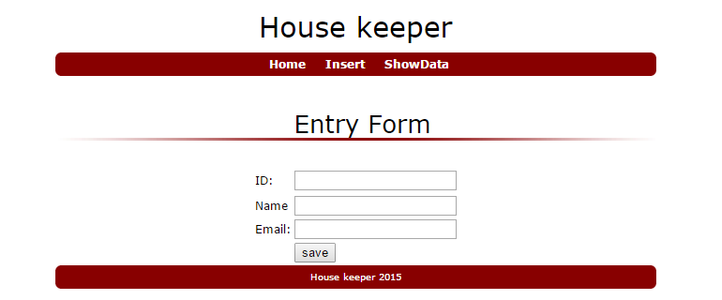

Step 5: The Web App
The web app is a a simple codeigniter webapp that displays shows deletes the logs and users .
